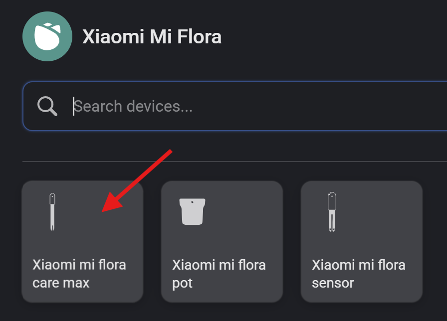

I’m unable to connect Xiami mi flora care max to Homey Pro2023. It says: No new devices found.
  • I added the device to Flower Care to get latest update
  • I disconnect the bluetooth from the phone, so device isnt connected with 2 devices.
  • I do see the device with bluetooth in Developer Tools.
  • I restarted the app
  • I rebooted Homey
What am I missing? If I connect the device to my phone, it is instantly recognized.
Edit: it does recognize Mi flora flower care 1, that is not the product which says is delivered by bol.com
The app?
Because you don’t mention it: You probably have to install the Xiaomi Mi Flora app first, this app claims to support the ‘Xiaomi mi flora care max’:
Yes, i did install the app. There it said: no devices found.
I should have mentioned it.
What did you order then ? Maybe post some P/N or link to the product, or pictures with some device specifications.
I ordered EAN 6970254420067, which says Flower Care Max.
On the packaging, they put a new sticker over an old sticker.
Did they put the wrong sticker on the wrong product?
Just to double check the obvious: did you select the ‘max’ version of the device when adding it to your Homey?
That’s the thing.
It wont recognize the max (it says no device found).
It only detect flower care 1.
Yea, im pretty sure they put the wrong sticker on it. If you search on the barcode below the new sticker, you get a different product.
Most probably, the number below the sticker is pointing to EAN 6970254420012 - Flower Care Smart Plant Monitor Official European Version Real Time Sensors for Soil Fertility Humidity Level Light Temperature iOS and Android App: Amazon.de: Garden
