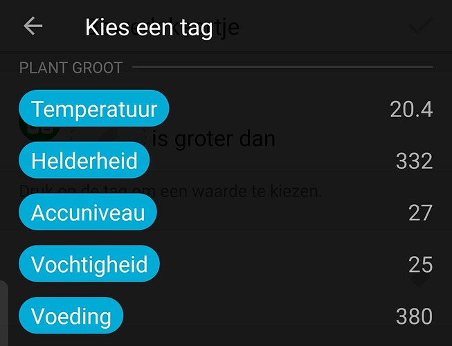

How do you get the moisture levels on the tiles? Mine only shows temperature, lightintensity and battery
Install the v4.0.0. Testversion, that should do the trick.
Then moisture (vochtigheid) and nutrition (voeding) levels can be selected too

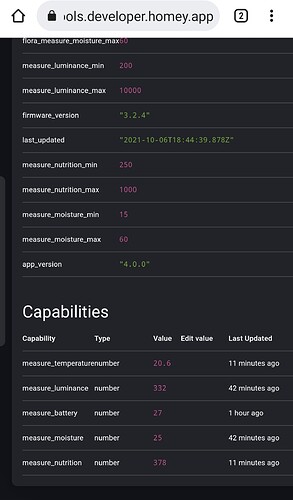

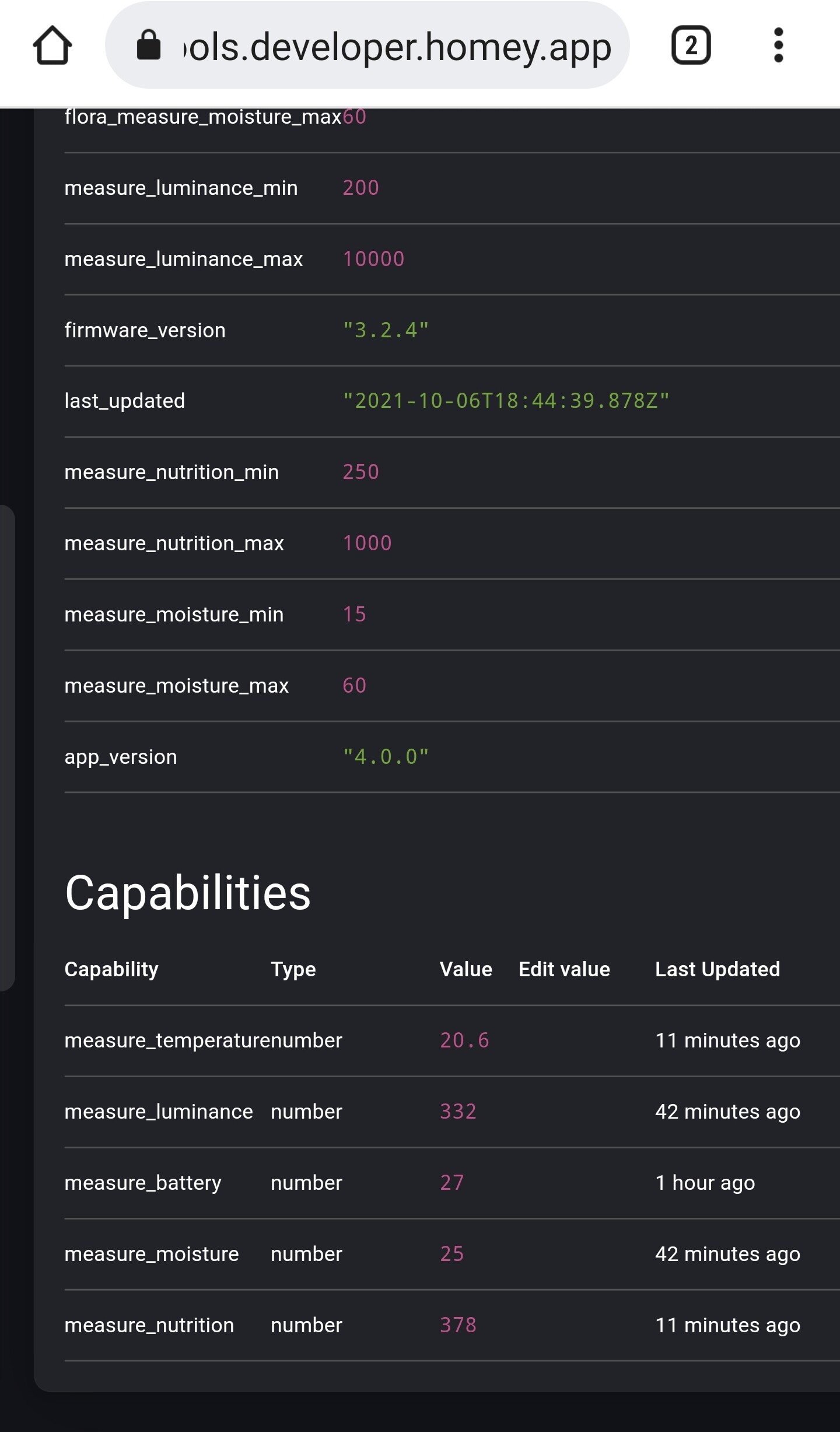

I have a moisture value that doesn’t update. It has been silent for 3 days now. I added the sensor to the flora app and it says 33% moisture level (see attachement)
The rest of the values are updating just fine (see attachement)
Any idea what it could be?
Edit: pulled the battery, blew some compressed air through it, smacked it around and now its updating again. Don’t now what did the trick but its working again :sweat_smile:

Yes, these are the current and available capabilities
The values represent the recent values of Insights graph “Aug. until Oct.”.
So only Insights kept the old capabilities as far as I can see.
