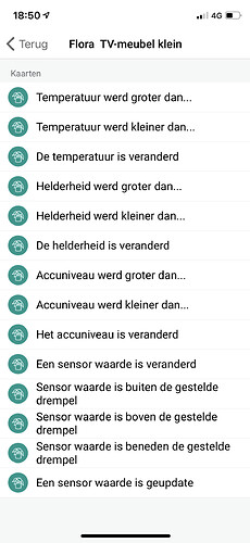

Connect one by one, because of BLE limits. If it fails it is retried 3 times.
The 3th times it is throwing a timeout flow trigger card.
Were can I find the failed trigger?
It’s only a global card, so there is no card for a specific device.

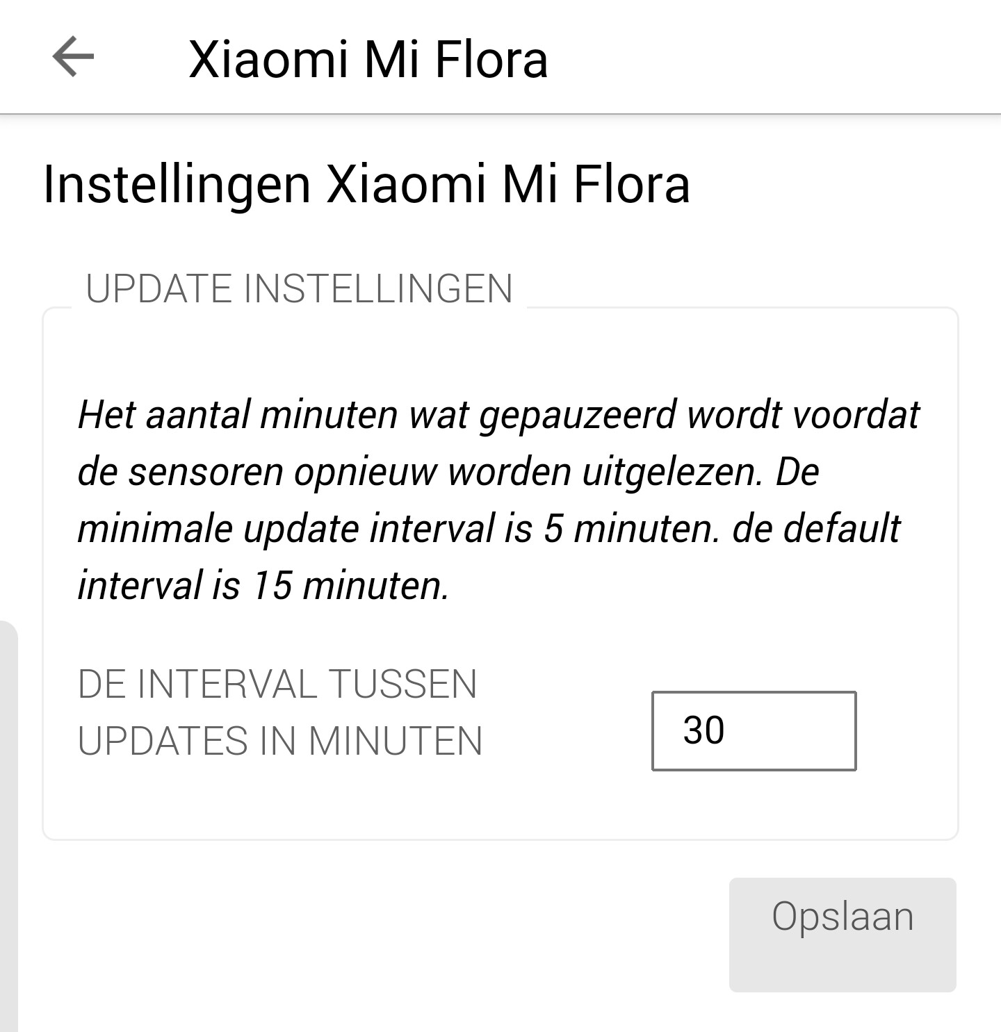

Now every 30 mins. And it stops when I give the poor things water :crazy_face::wink:
(…more>apps>xiaomi mi flora>Configure)
I experienced the same behavior. Humiditysensor fluctuates between 1 and 6%. Could be the airhumidity or plant is sweating. I just need a message that plant requires water in case I forget it and humidity drops below 5% or it dries out. I can’t see how to do it with the given options with this behavior of the sensor. I’m going to see if changing the range is helping.
