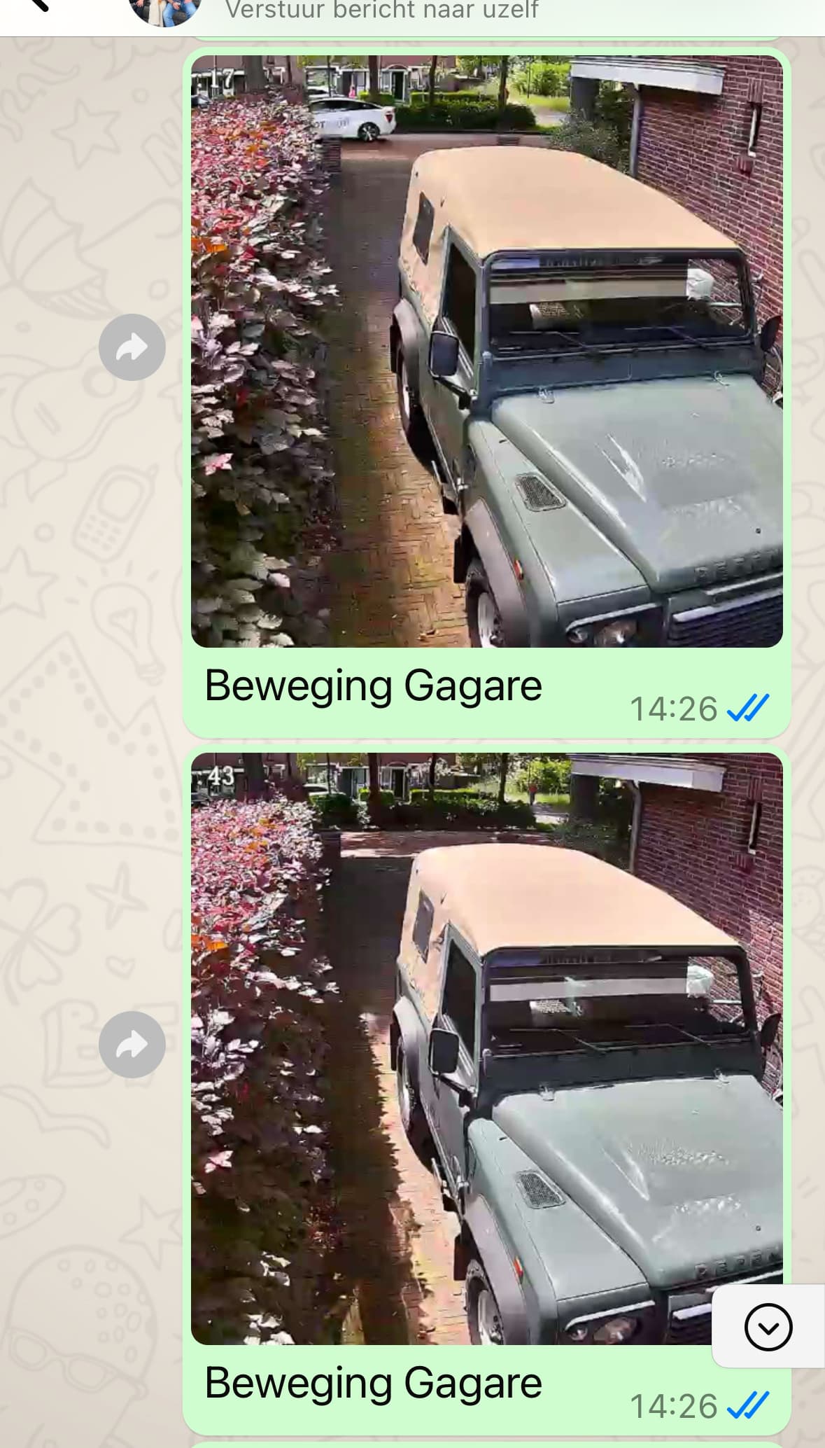

A taken snapshot,
(though a flow) by camera (jpeg format). I did work in the beginning.
@Jelle_Romijn please specify app. I can’t do much with this images :sweat_smile:
For me it works as is all so to send a picture if somebody ring at the door.
Setup with ubiquti G4doorbell and a UDM-Pro (icw Ubiquti - Protect)
(so no problem)
