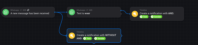

I have two mobile numbers in my Homey WhatsApp. One from me and one from my partner. If I create a single flow it works. If I create an advanced flow, I can’t get it done. Picture 1 does work.
But picture 2 doesn’t work. Under Sender you will see Sender, of course I entered my 06 number there and that of my partner (but left out here).

Picture 1:
Picture 2:
@EdNL there is a difference in the AND check in your flows. not sure if that on purpose?
But best thing to do is something like this:
Then you can test what works and what not :slight_smile: (make sure to save the advanced flow)
@martijnpoppen
When I do this, I simply receive a text message on my Homey Whatsapp number, but I do not receive a text message back on my own Whatsapp number with the information I request.
