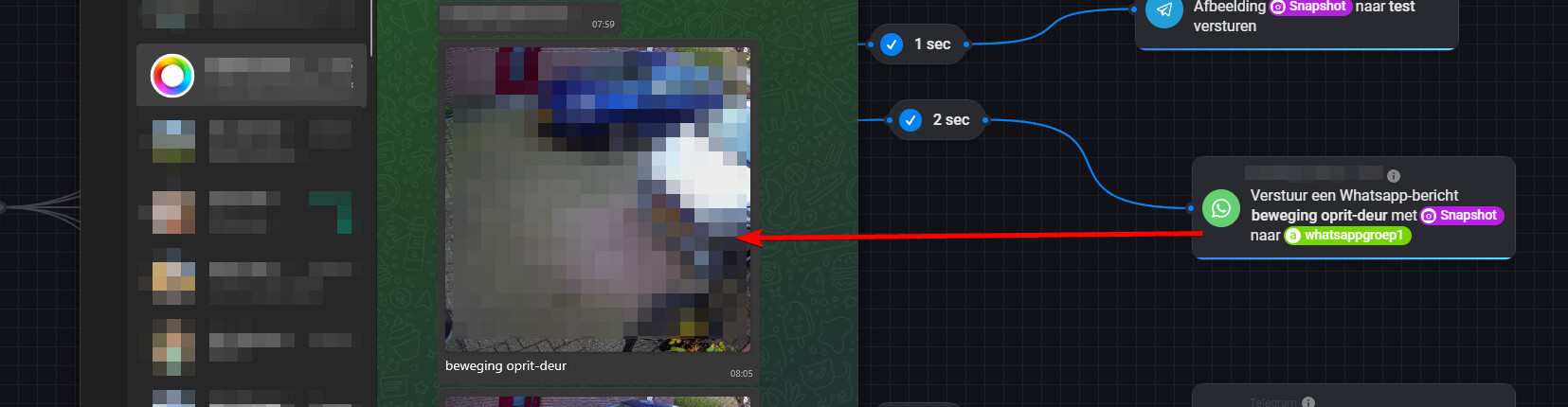

maybe I’m asking too much, but this totally does not work (no images sent):
furthermore, in this less complicated scenario, when the whatsapp-app is invoked several times (e.g. movement detected, so the security camera triggers several times), it stops working (i.e. it stops sending images and messages alltogether).

sorry I cant see in your image why it doesnt work :wink:
No images, or no messages at all? I tested yesterday, even when sending a wrong image it does send. Also you mentioned before it does work, so i’m trying to understand what you mean
And Calling it too often, yeah thats a issue. But I cant really work around that, that are the limitations i’m facing of this implementation. That’s also mentioned in the disclaimer, you will risk a ban as well with spamming the whatsapp server
Can you try to repair your device, I asked that before, but not sure if you did that

@TMS_TMS you’re still on a older app version. so that doesn’t include the fixes i made for you
@TMS_TMS I managed to reproduce the issue with the image. seems like it’s related to the image refreshing every 1 second, and that why it breaks on the app. Will try to make a fix
