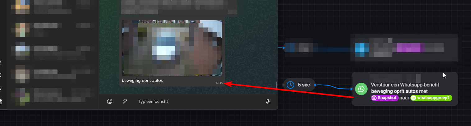

Hi is it possible to change the image size? I only see half of my images in the messages (version I use is 1.20.2) It was working ok in version 1.19
