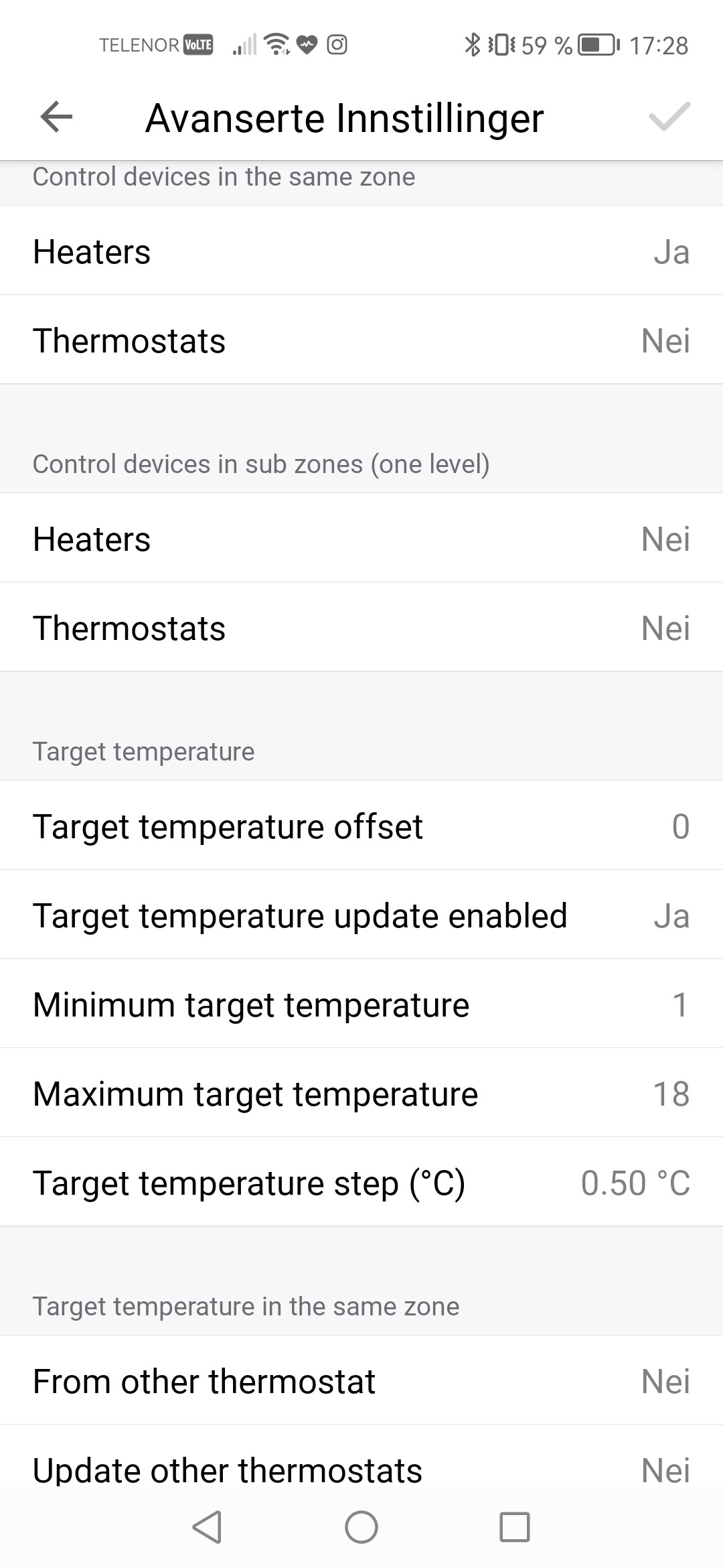

It seems impossible to set the setpoint to 1 degree? When I do, it says 5 in the VTherm display. And yes, I have set minim target temperature to 1 :slight_smile:
Any advice?
Anders
Yes, I guess you mean if you have more than one temp sensor in the same zone?
Can you send me a screen dump of the settings for the VThermo ?

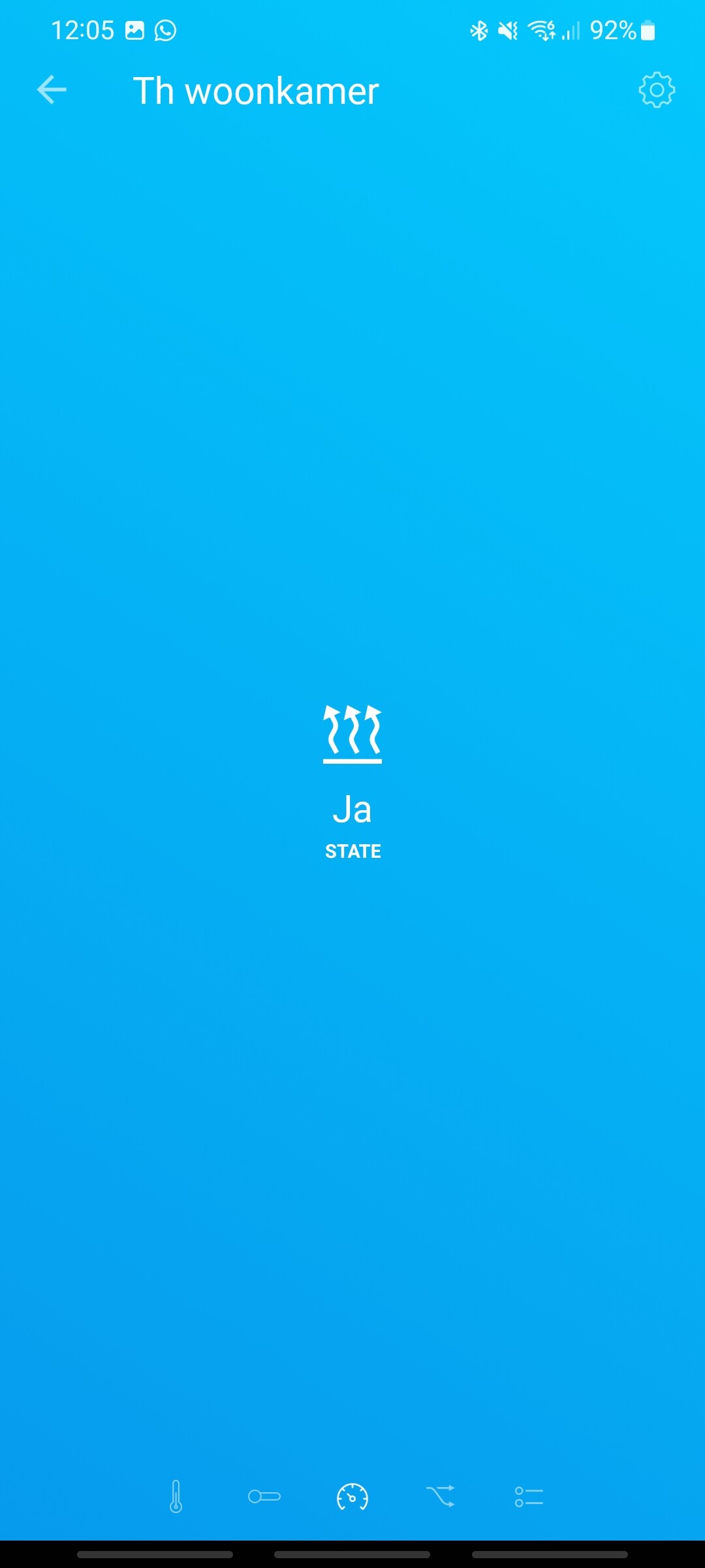

any idea why the ‘state’ stays on when the room is already up to temperature?
It’s probably due to hysteresis. You can set it in the option. It can be positive or negative or equal to zero. Generally you set it considering the inertia of your system. If your system is very reactive you should put very close to zero. If instead you have a huge inertia (Such as very thick floor heating or cooling system), you should enter negative value in order to stop the heating (or the cooling) some decimal before the set point. This should help to reduce the swinging of the temperature around your set point.

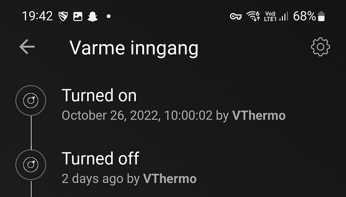

The past 2 days we’ve woken up or come home to 1 or 2 very hot rooms. All of these have floor cabling switched by a plain Shelly, governed by a VThermo and an Aqara temp sensor.
Today’s example:
Notice how the Shelly is on, when it should be off.
Its event history:
It’s been on for more than 9 hours.
The VThermo:
The Shelly event correlates with the “Active” VThermo event, and never turned off afterwards.
Toggling VThermo off/on had no effect at this point (it seems to think that the Shelly’s state should be off, and thus no need to change anything). Manually adjusting the target temperature above the room temperature and back down, seemed to shake it loose, and things are back to working as normal.
It seems to be a regular thing, but I can’t understand why, or how to provoke it! What am I missing? (What does the “Active” event refer to?)
