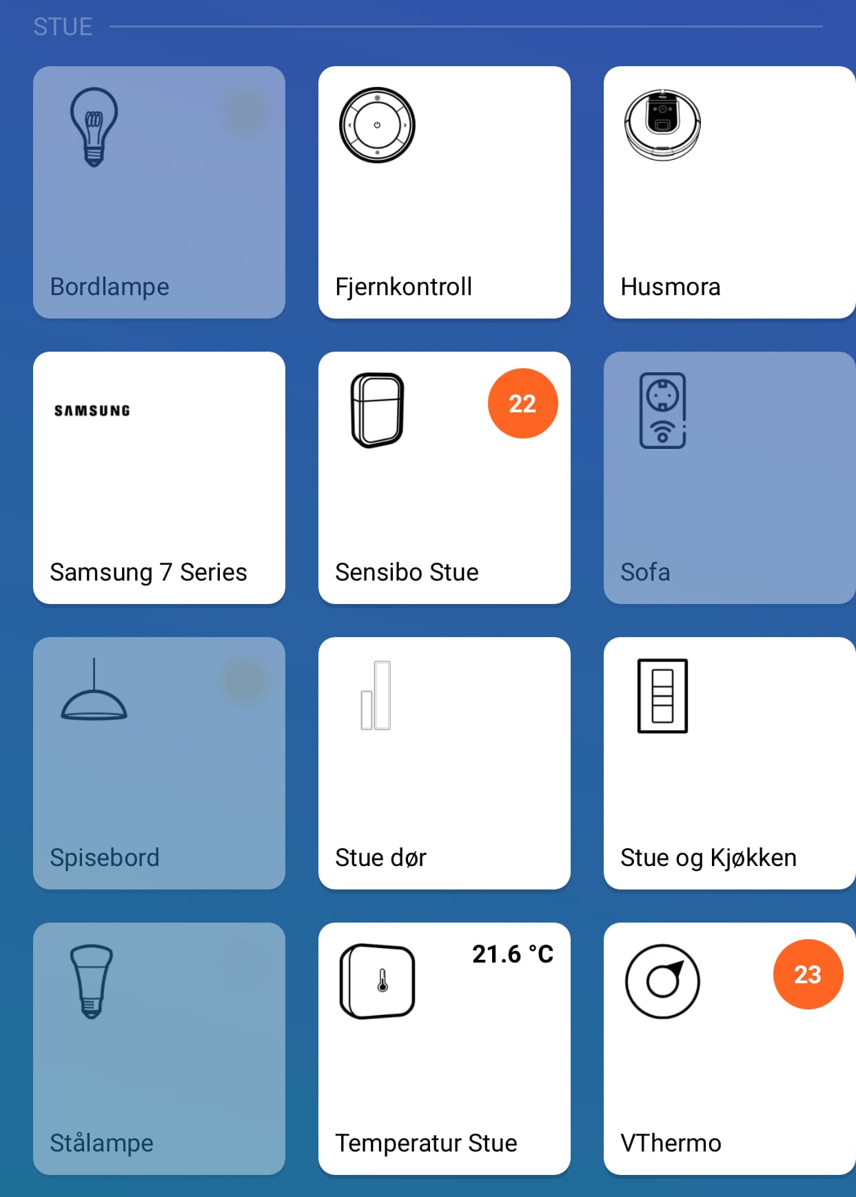

Can you help me to see if I’ve set this up right? I can’t get it to work.
My wish is to control my heat pump (Sensibo Stue) with Vthermo based on a certain temperature from an external temperature sensor (Temperatur Stue).
Screenshots:
Hi, your Vthermo should be in the same virtual room of your heat pump, in yours there are really many devices.
It’s in the same room as you can see in the screenshot.
Yes you are right, but did you try to put in just the three devices (VTHERMO, AQARA and the heat pump), just to be sure and reducing the number of variables that can interact. please click also yes in “controll device in the same zone” heaters
Looks like the config is OK. Check ​that VThermo has the same temperature as the Aqara (21,6)
When you check “Control devices in the same zone - Thermostats”, VThermo will control the Sensibo thermostat. It will set the target temperature of the Sensibo high to turn it on, and low to turn it off. About 2 degrees higher / lower.
So turn the target temperature of the VThermo high, and the Sensibo target shall be around 2 degrees higher that its temperature. And correspondingly for a low temperature for VThermo.

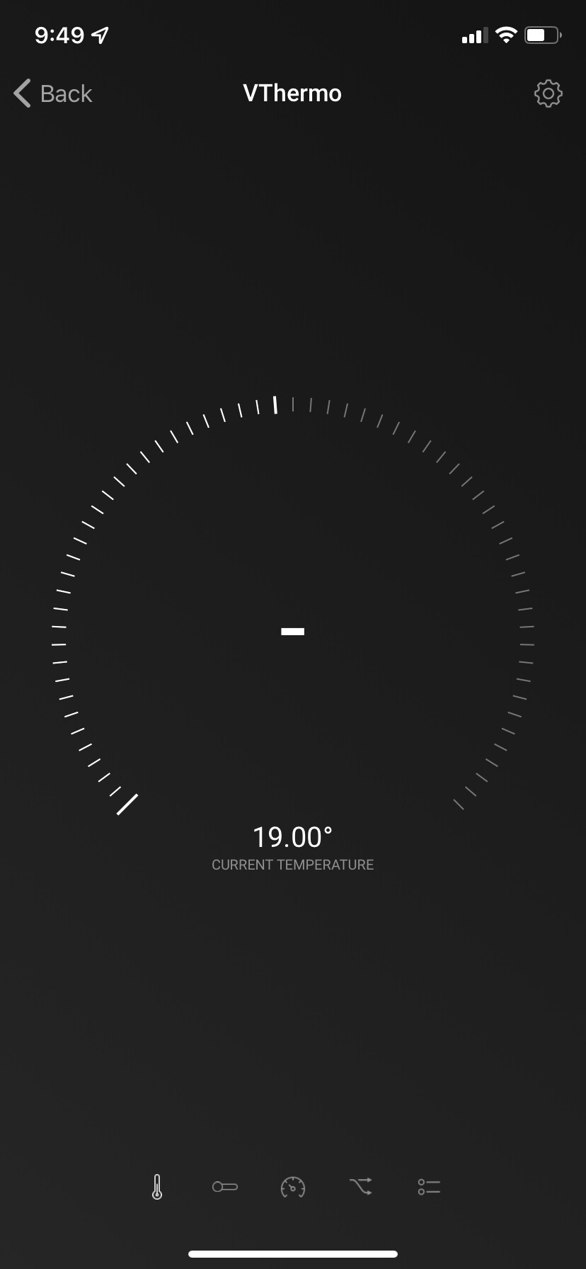

Ok, I have the ball, early 2019 versjon. I got an Aqara temperature sensor and Aqara smart plug connected to a heater. Smart plug is defined as a “heater”. VThermo is placed in same zone. VThermo seems to only see the measured temperature, but doesn’t seem to recognize the heater.
You must set the target temperature of the VThemo. Slide the wheel from bottom left, and up. Or you can use a flow to set the target temp.
