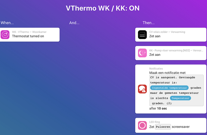

In my situation, if a VThermostat reaches the programmed setpoint, it will tigger this flow:
The following screenshot shows the same, but in my dashboard:
If triggered, the flow will activate a Fibaro relay, that switches my heater on.
So, the average temperature of the two Aqara temp sensors is seen in the Vthermostat (=> 20,2). It is this value that act as a setpoint trigger, as defined in the Heating Schedule App.
PS
I discovered that “Thermostat turned on” trigger card is not the same as ''switched on":
So, use the correct trigger card!

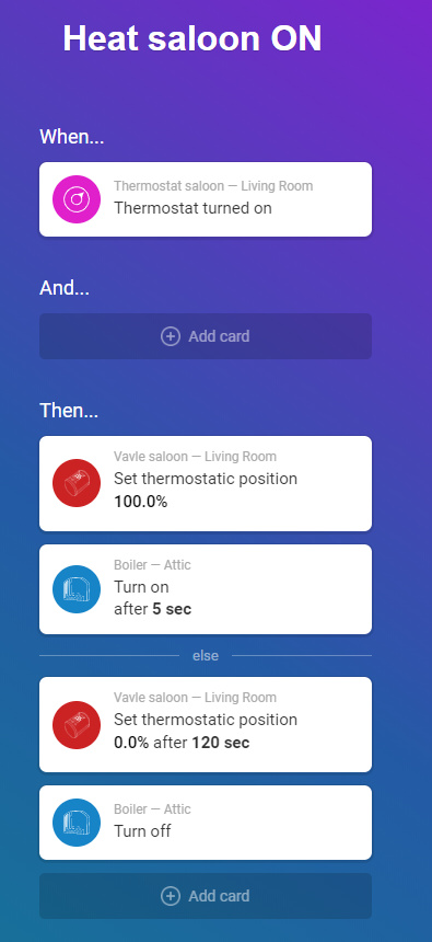

Hi Eternity,
Thank you for the reply.
I did this flow but not tested yet. I’m at work now.
Looks Oké!
You have Eurotronic Spirit valves, I see. Why do you alter the thermostatic position manually? In my case I have the valve set to the required temperature.
Hi Eternity,
I set manually the valve because otherwise it take much more time to heat the room if I use the temp set on the valve.
