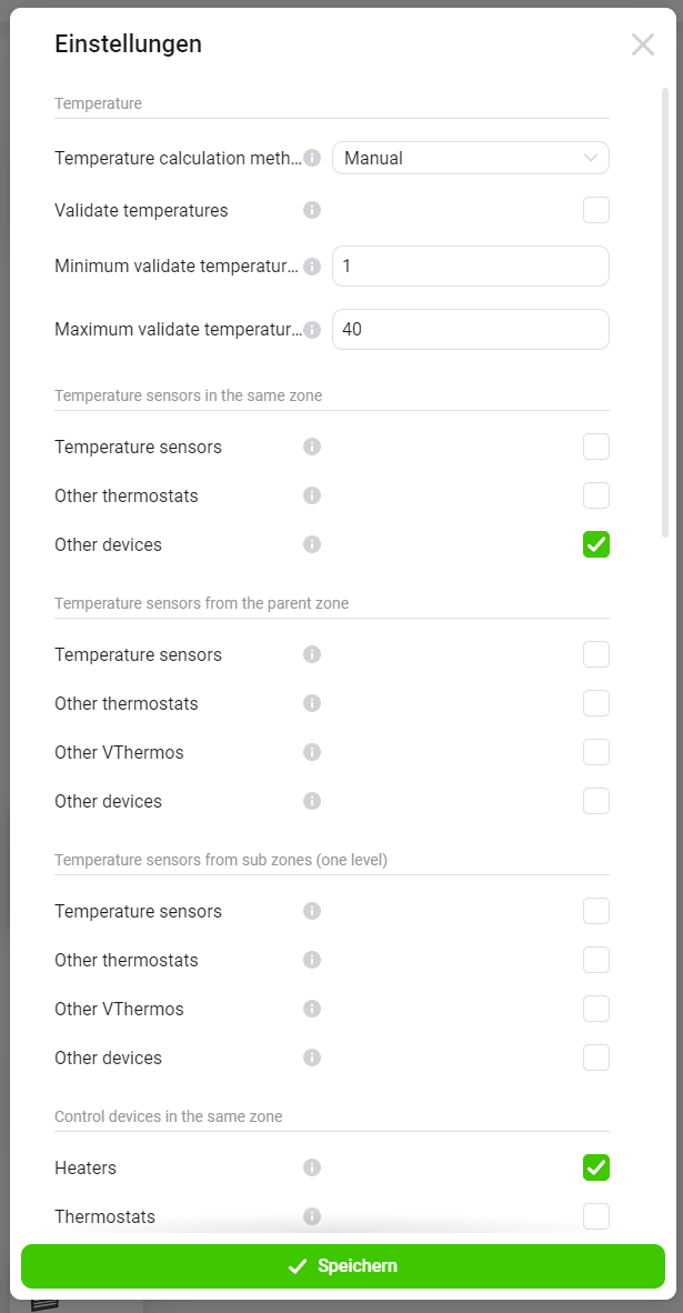

Since you are updating from a flow (Manual), then you should uncheck “Temperature sensors in the same zone - Other devices”, and see if that works for you.
Hello @balmli , i unchecked it, but the same problem, the flow wirte the temperatur, it becomes blue for 1 second, than black :frowning:
Best regards
Hello @balmli, if i unched “other devices”, then i heve the same effekt, temperature gets blue for 1 second, than vlack, if i check it ist works, but not on the other 2 Vthermos, very strange.
thansk
philipp

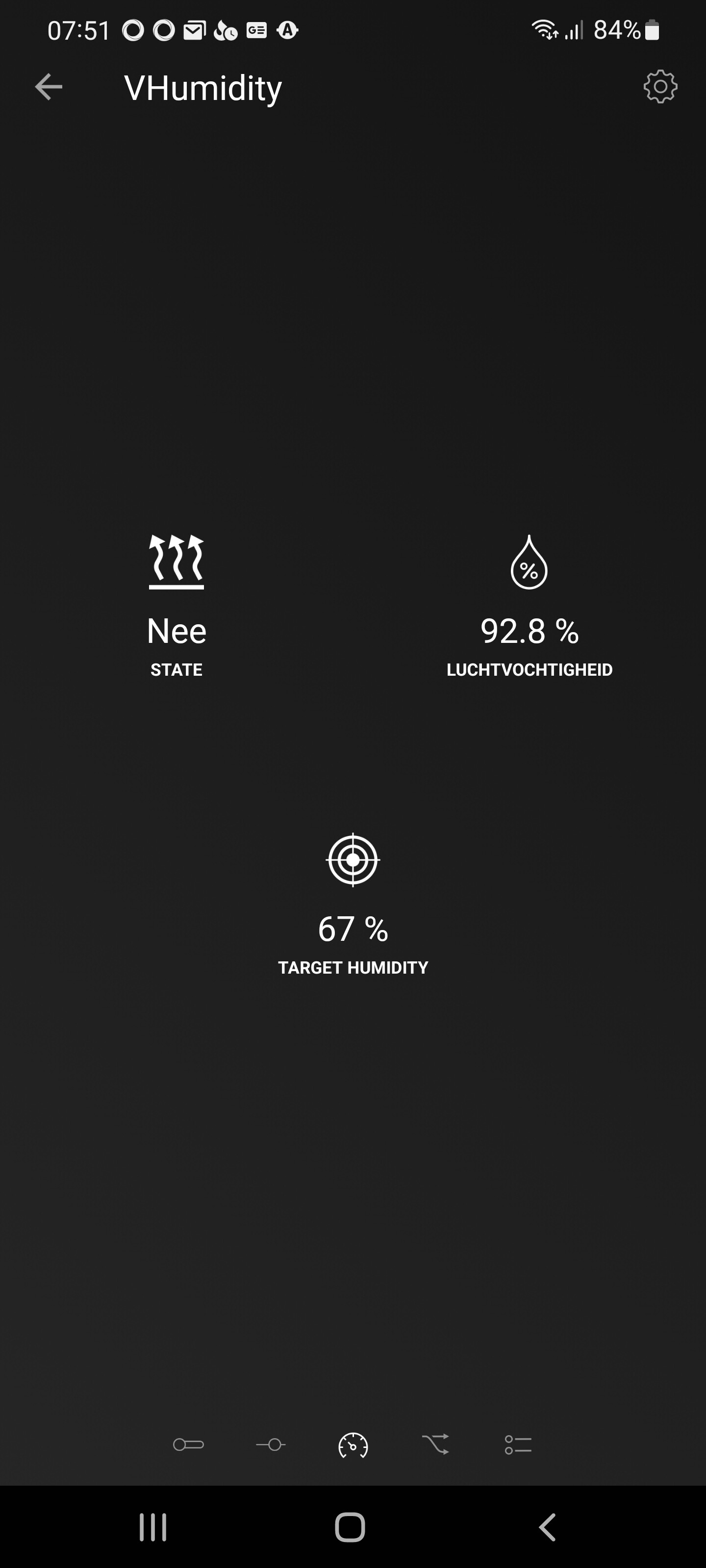

@balmli your very underestimated and highly esteemed app stopped working. I had to set my ventilation by HAND!!! UGHH :wink:
No seriously, my Vhumidity is not responding, what to do?
