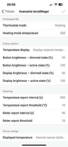

I have problems with VThermo controlling my Heatit z-trm3 thermostats. When I set VThermo to ie. 26C, my VThermo gets set to much lower than this, even if there is 15C in the room.
For some reason the room sensors on my Heatit consequently shows too low temperature (currently 15C while there is 21C in the room). My floor sensor consequently shows too high temperature, so don’t know if that’s the aolurion either… Is there a way to bypass the in-built Heatit sensor, so that VThermo controls everything?

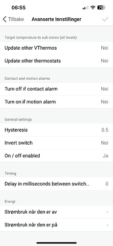

These are my settings. I use the old Homey and a separate temperature sensor in the room (Netatmo).
