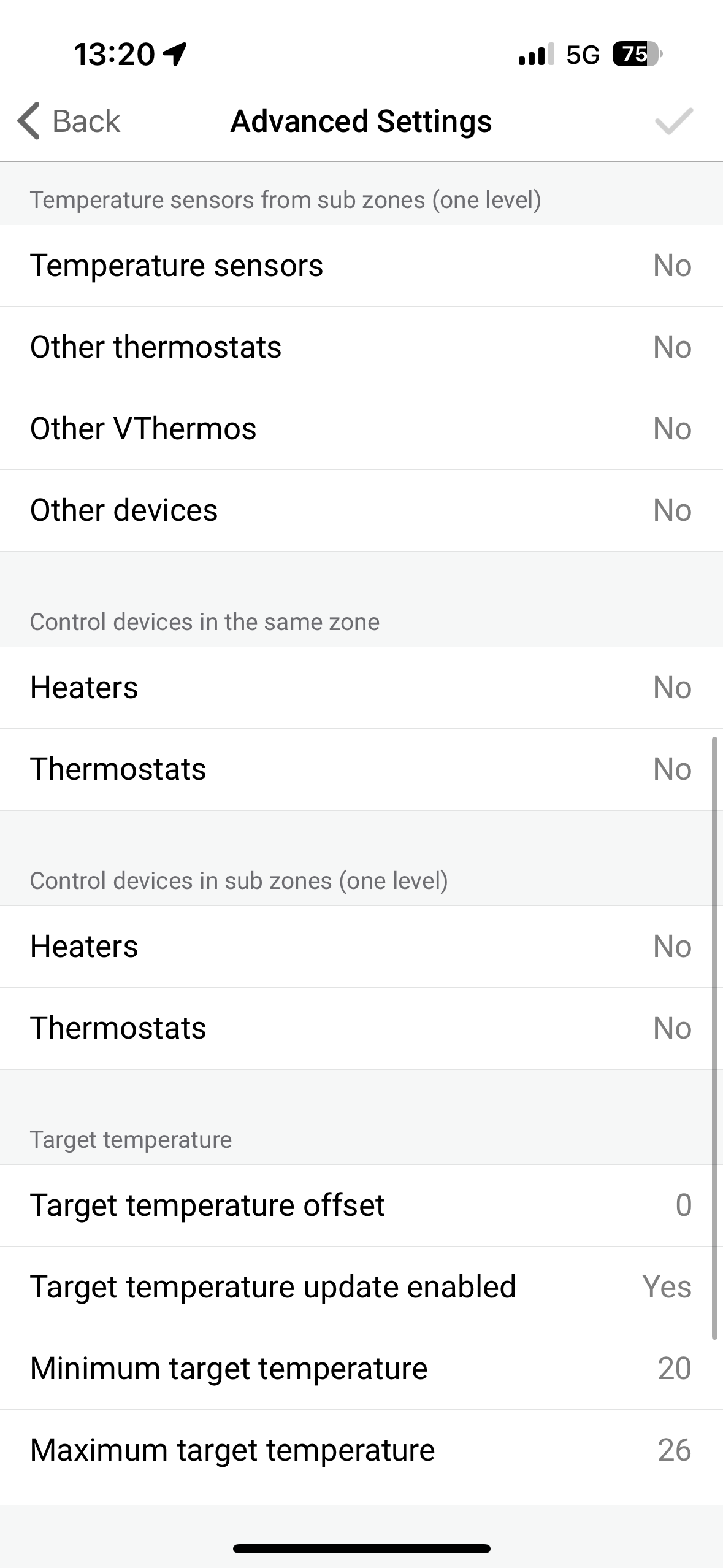

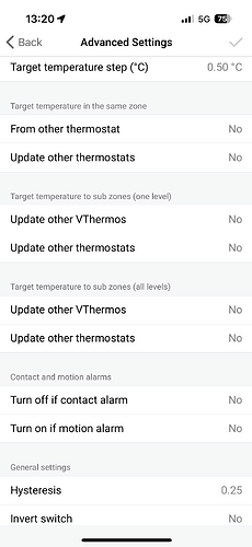

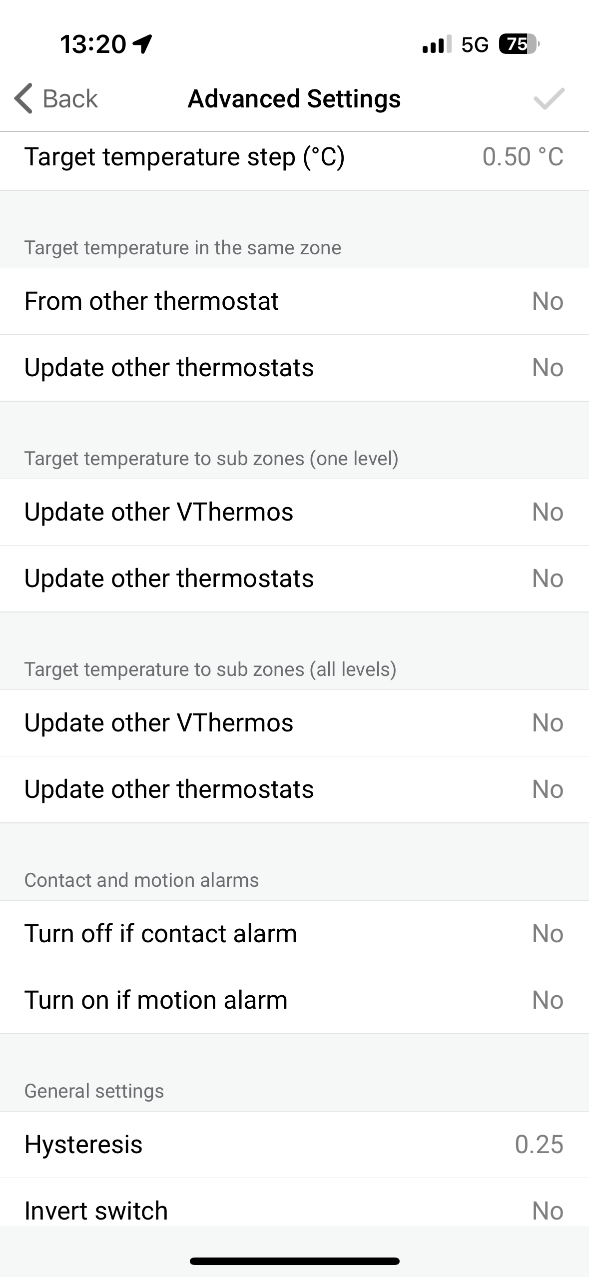

Send a screenshot of the VThermo config (adv. settings)

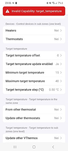

Hello. I’m trying to use vthermo with my new homey pro 2023 but it will no longer work. I have the exact same setup as previously with temperature sensors in the same zones. The temperature will not update, so the virtual thermostat is not working at all.in addition, i cannot edit device settings as I am getting the following error message. I tried reinstalling vthermo to no avail.
