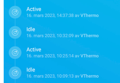

Using 1.10.2 with Homey Pro 2023 I discovered one of my zones where heating, even if the temperature was way above the set point.
From the event on the VThermo I can see it’s entering Idle state at 10.32 today
From the event on the Wall Switch I can see it was turned on at 10:25, matching the Active state, but the Idle state seems to got lost, so I dicovered it and manually shut off the swich at 14:37
Maybe the VThermo should discover this and repeating to turn off the Switch ? The Insigth from the Temp sensor is getting the increased temperature, and VThermo should be able to try a little harder to turn off the switch …
