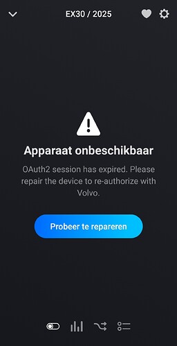

Device Unavailable
OAuth2 session has expired. Please repair the device to re-authorize with Volvo…….. and after authorize it is gone again after half a day
Half a day with the current version of the app sounds strange, but … me and Claude did another attempt and it seems there may be problem with using the refresh token if there is connectivity problems. So if your home network is very spotty then maybe this could cause problems continously.
