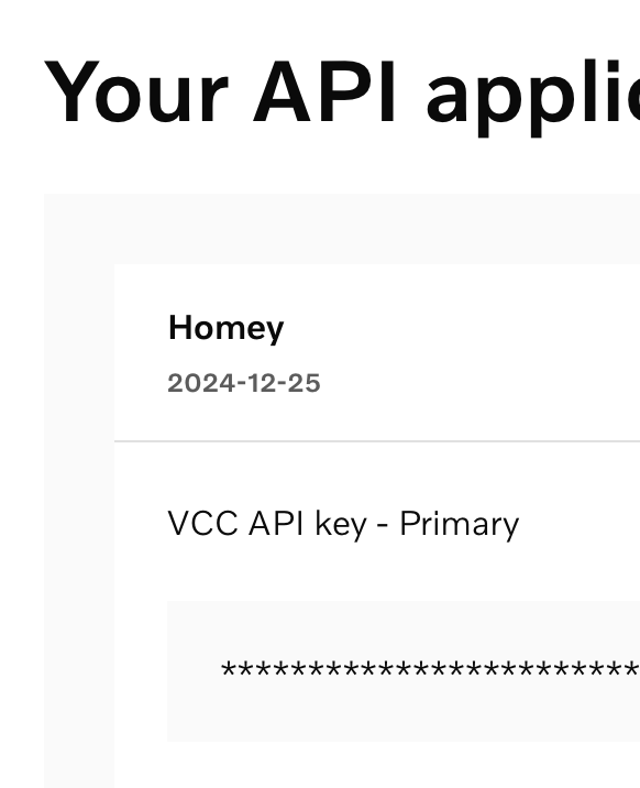

How can you generate the VCC API KEY from the developer account?
I was also wondering about this since the app description states: “The new Connected Vehicle device type supports Android auto based cars, model year 2022 and later. To add this device type you need to register at the Volvo developer portal and get hold of a VCC API key.”, I reached out to Volvo’s support today regarding this but the guy I spoke to did not know anything about this and asked to return after contacting the development team. I got an s90 from 2018, hopefully it is supported…
Follow these steps for generate API
