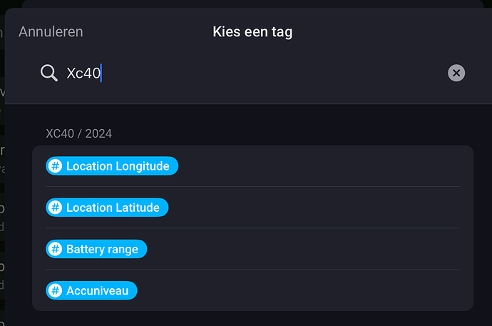

I have a full electric XC40/2023 that is connected as device type ‘connected vehicle’ to homey. I’m trying to make a flow to warn me when the car comes home and is below xx% charged. However, I see no AND cards looking at the charging level. I do see a WHEN card on charging and an AND card on being at home but i’m afraid that will only trigger in the very slim chance that my charge goes down 1% just when I’m whithin 50m from home.
Is it possible to add such an AND card or am I missing smart other way to do this?
Robert
You need to use the logic cards for these kind of checks:
The charging level is a tag…
