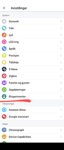

Go to settings in Homey app, click on Experiments, then activate the Power User. System should now be available.
Thank you very much @Yankie!!!
