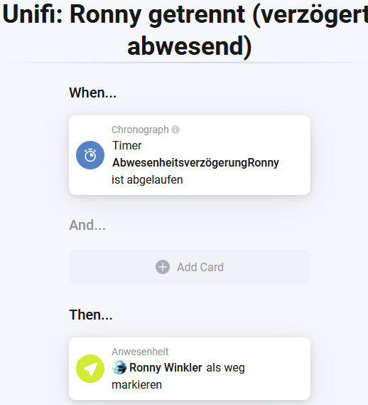

The Unifi device represents only the phone, not your person (Homey account). Just set you at home/away in the flow.
I use it rhis way to make all other home/away logics with the homey user state.
In addition I use a timer for away state to prevent a state change if teh phone is roaming between APs.
Unifi-Connect:
Set me at home and stop timer (if running).
Unifi-Disconnect:
Start timer (delay is taken from a logic variable):
Disconnect-Timer (delay) finished:
Set me away.

Just take my Screenshots as example (my last post).
Use Chronograph app for a timer.
You can’t work with timer in one flow. Xou have to start timernon disconnect and react on the timer event in a second flow. If you get reconnected while timer is running then stop the timer.
This way you get only set as away if you are offline tje whole delay (timer running).

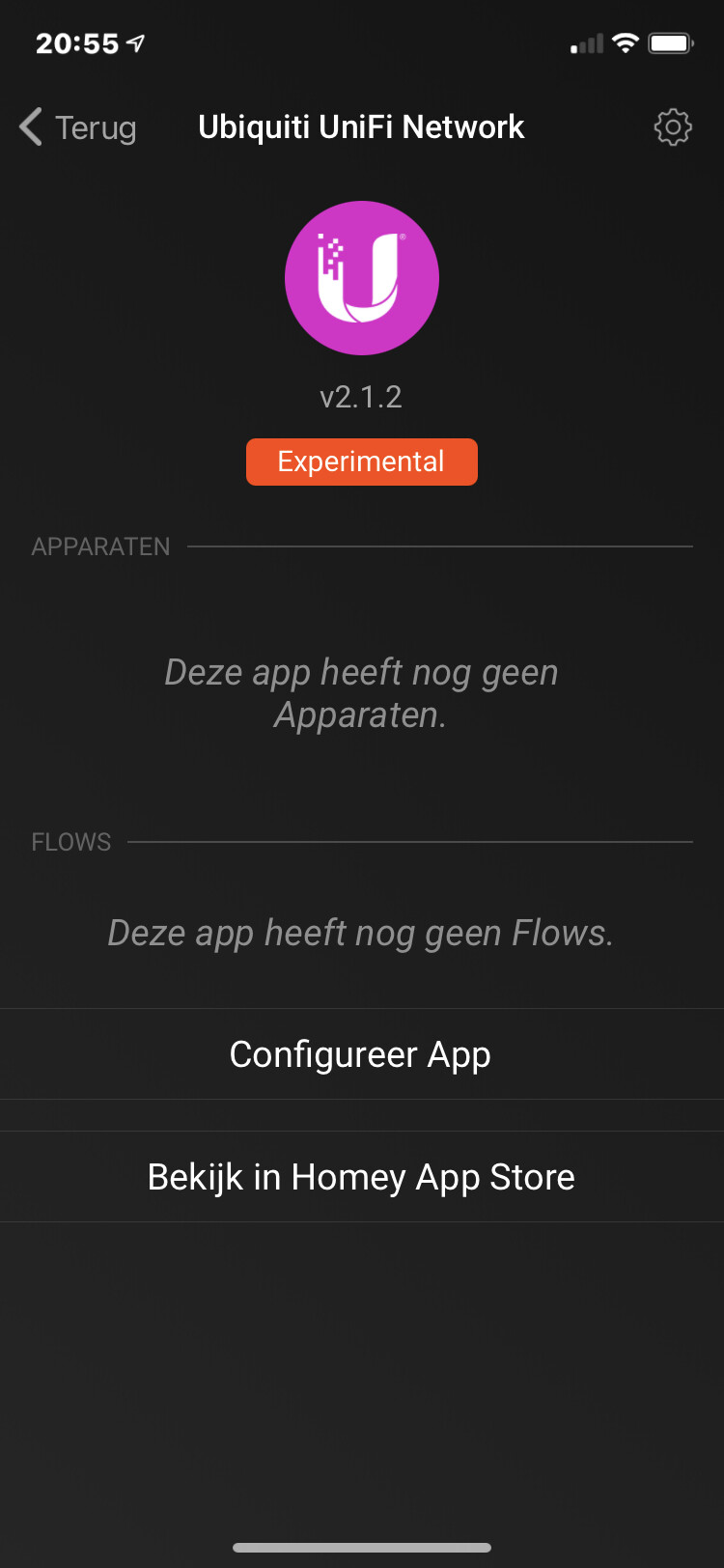

I can’t get it to work with my USG-Pro and My cloud key Gen 2 (2.17) and Unifi 6.2.25.
trying Local super admin and cloud (main+owner )user. on port 443 and latesr experim=ental version 2.12
(I can’t add (or have) any devices(yet).
please help.

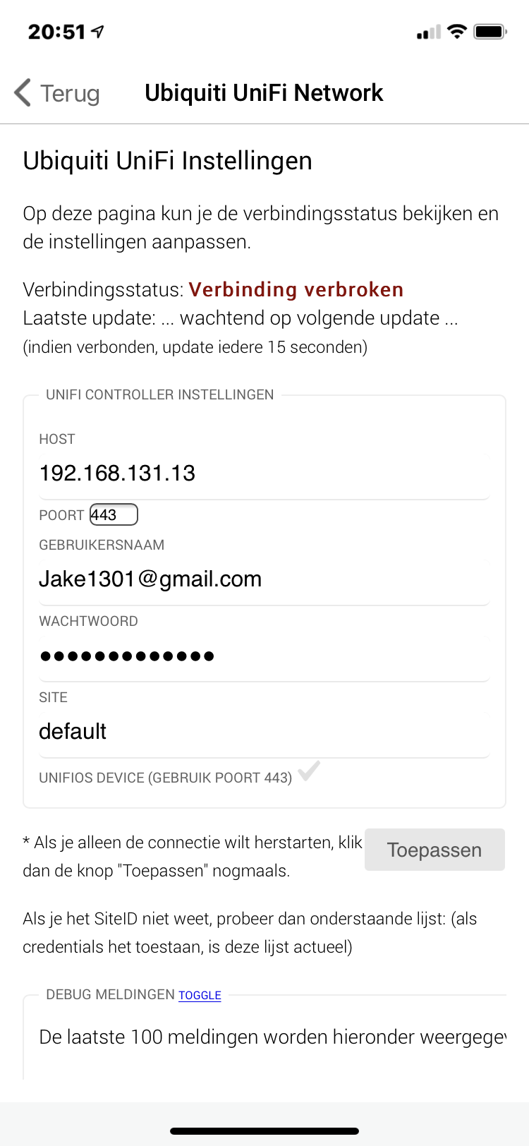

Can you send me screenshot from you app settings? by private message?
Red Iphonitis rigorosa : level 11
Please check the UnifiOS option!
Ooops … Didn’t know that was an option to toggle. :pensive: :blush:
That with the “default” as site did the trick(with the local Super admin (“DoctorHomeyPro”) ! :upside_down_face:
(“Default” or my real sites name “BazingaHome” didn’t work.)
It’s connected now.
Thank you very much.
