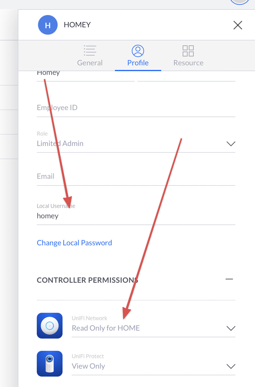

I finally resolved it!
If you want to keep 2FA (which you definitely should for obvious security reasons whenever possible!) do this:
  1. Login to you Cloud key over local IP from a browser (e.g. https://192.168.1.110).
  2. Go to Users
  3. Select your user you want to use for fetching data to homey (e.g. the owner account).
  4. Go to the tab “Profile”
  5. Enable “Local account” and enter a username and password.
That’s it on the Unifi side of things. Now go to the Ubiquity Unifi Network app on homey on your phone and enter the local IP of your cloud key, provide port 443 (https) and provide the LOCAL user that you just created in step 5 above.
That did it for me! You should avoid using your Ubiquity cloud account as suggested elsewhere.
