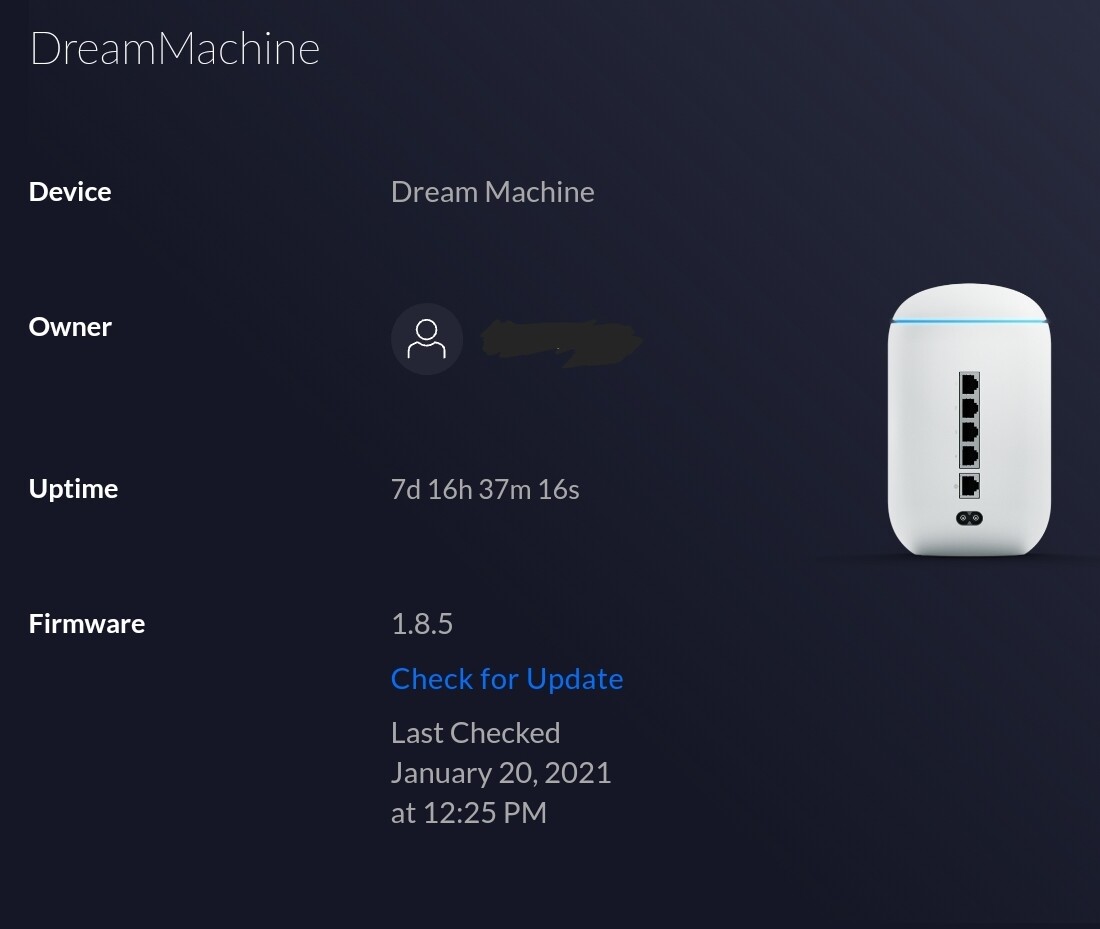

I have a UDM and would love to use this app but it won’t connect for me either. I’m running the latest firmware as well.
I have a same problem, all my creditals is fine, and i can’t connect. Latest app, and latest software, changed password and roles. CloudKeyGen2+

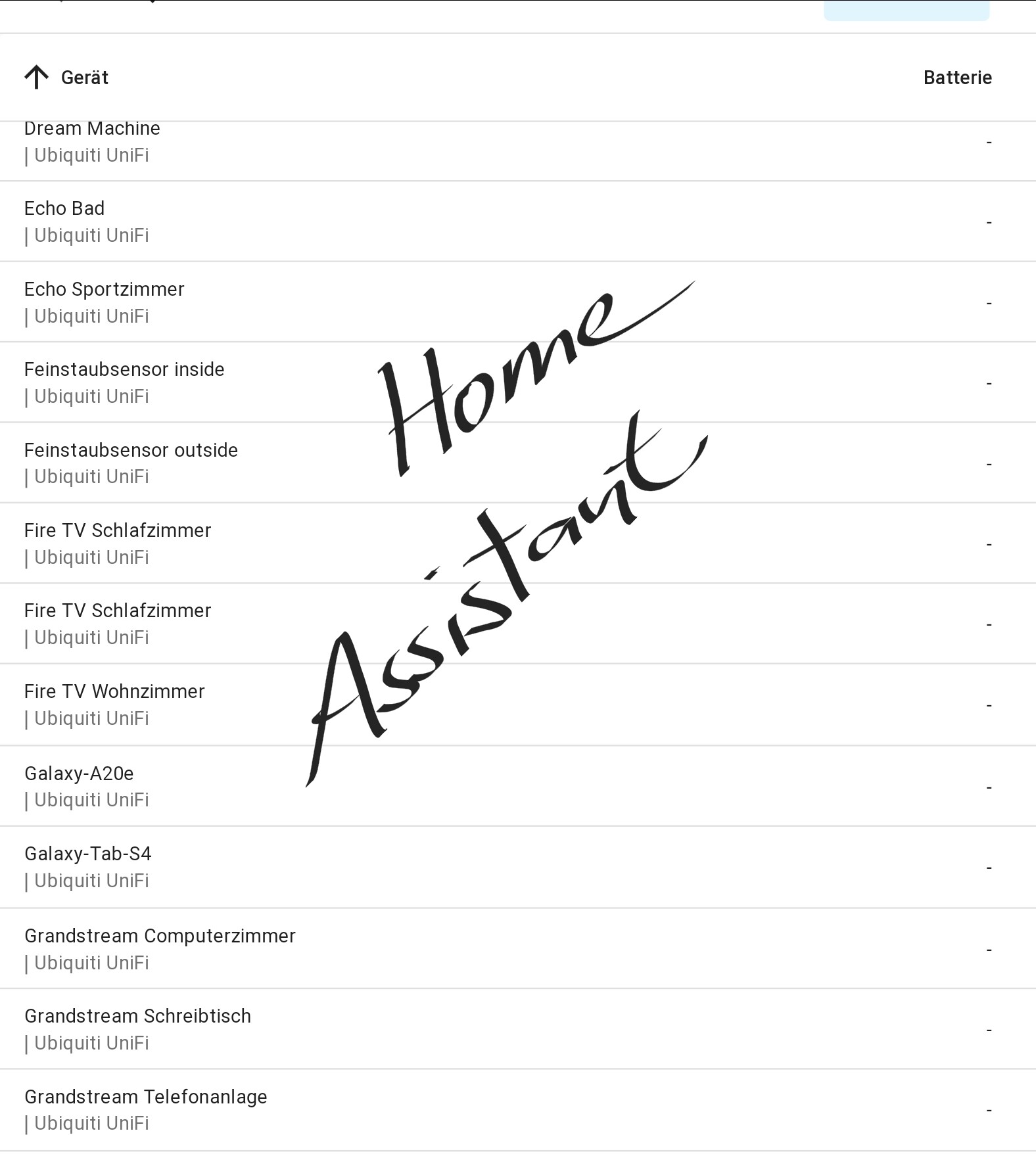

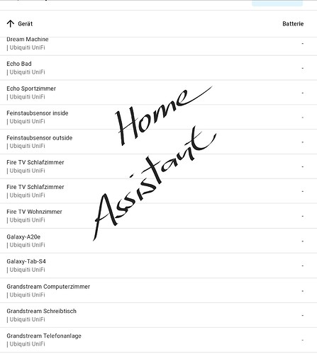

A connection with the DreamMachine is also not possible despite the changed port 443. At the moment I did the following: The DreamMachine is recognized by the Home Assistant on port 443. I then send the relevant entities to Homey.
