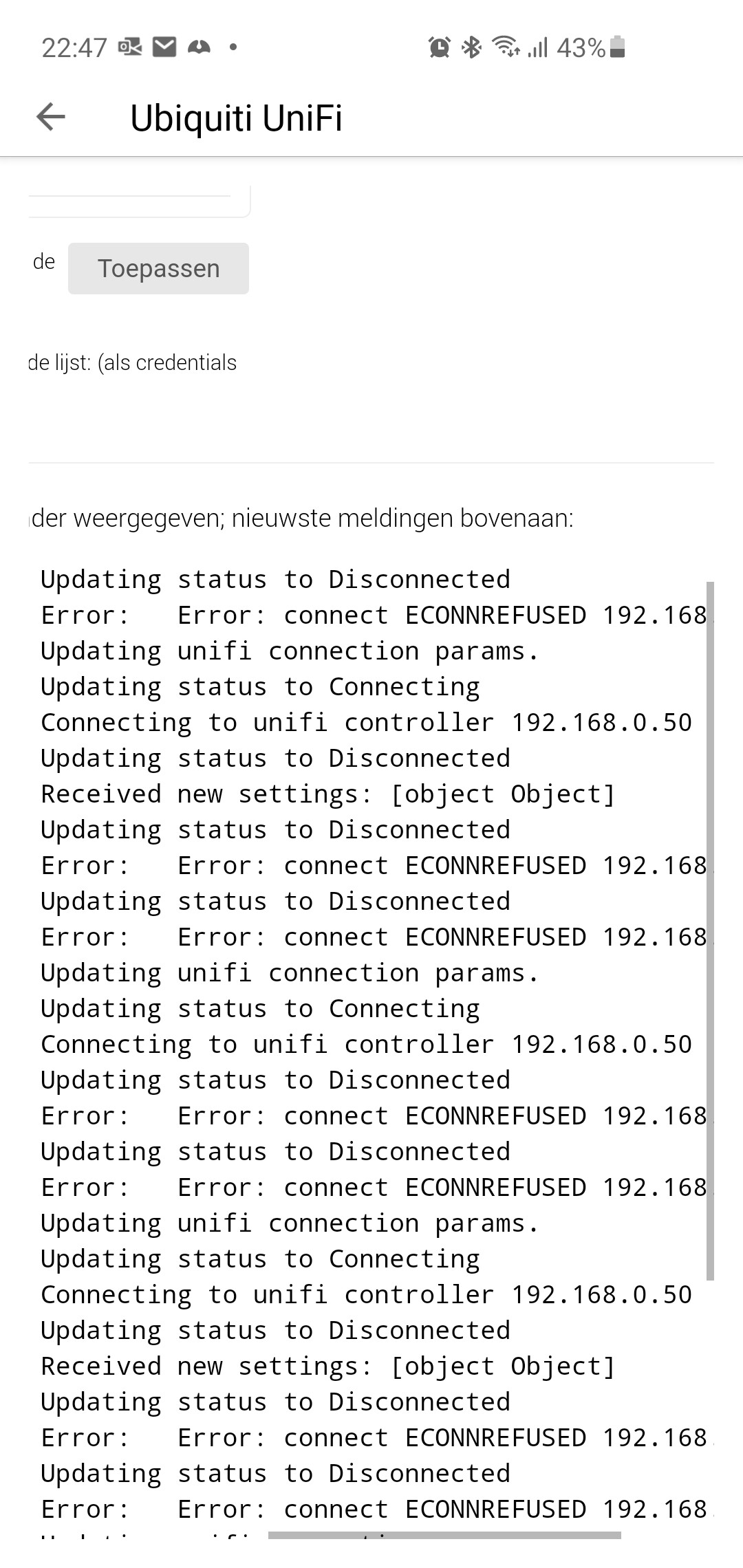

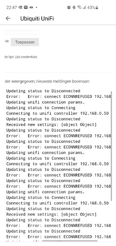

I’m trying to setup the Ubiquiti UniFI app on my Homey pro.
But when i’m sending the connect command i get an error i cant find anywhere:
I have my Cloudkey V1 on ip 192.168.0.50 static and site name is other then default but testet default, my site name is Hofstraat and tested it with that name and with hofstraat just to be sure.
account name and password is 100% correct tested/checked my credentials at my browser.
Does any of you have any advise?
Update:
I mixed up my ip’s there was a DHCP reservation for a non essential device on 0.90 but had a hard ip set to 0.50 wich gave me the idea that 0.50 was free but gave a ip conflict therefore it ran realy wonky.
Since i resolved the IP conflict Ubiquiti runs smooth.
Realy Nice the app!!
