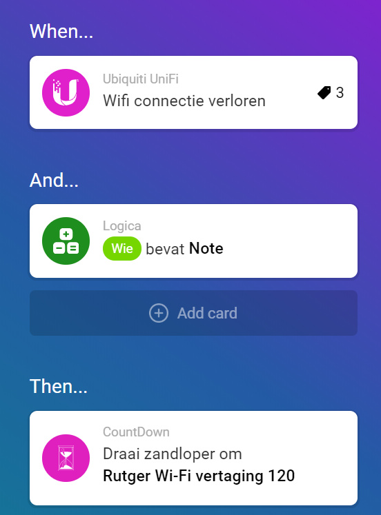

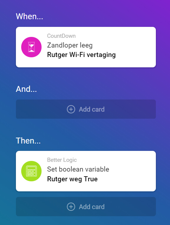

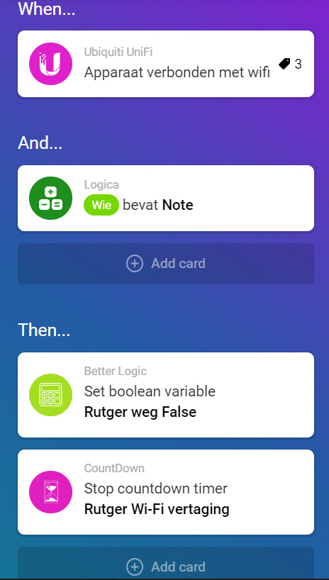

Hi Martijn,
Can you send some screenshots from your flows please.
Im trying to build them also because im having also the false warnings when the phone is switching between AP’s
I also have problems with the roaming inside the house. I work also with a timer but cant get it to work. You maybe have a solution ?
You can do this like this:
