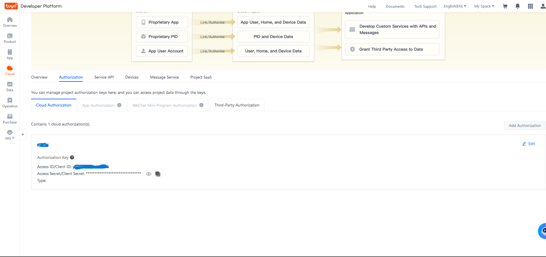

Hello, I have extracted all kinds of ID, keys and uid from devices in Tuya IOT cloud.
But exacly what API Keys and Secret am I supposed to fill in under the setup?
I just want to add 3 sockets I have, I have tried with the Access ID and Access secret for my account. But adding just one random device wont let me add anything. And how am I to add more devices than one if I can only add one device ID…
