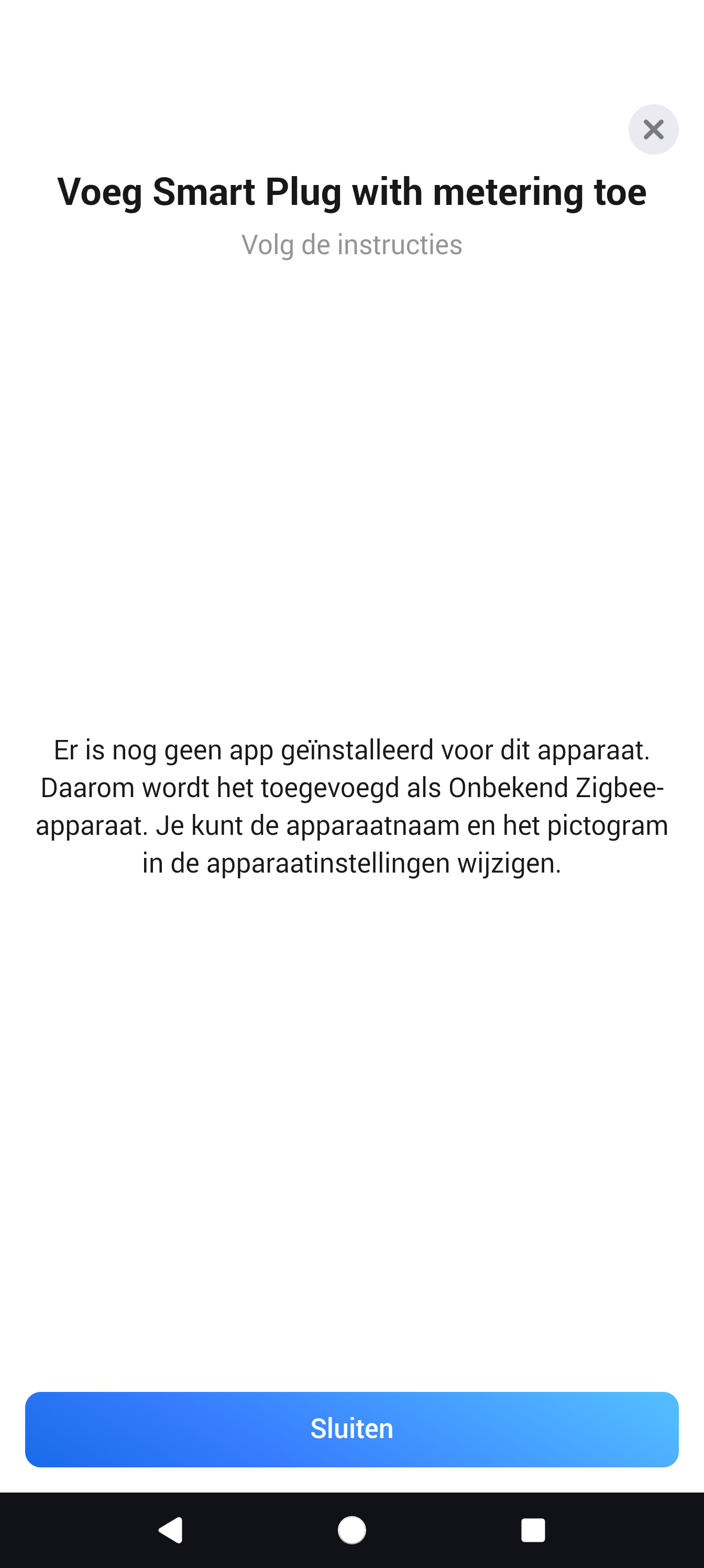

I have (Neo) Zigbee smart device’s with metering.
Says that the device is added on the first page.
  • _TZ3000_w0qqde0g / TS011F (Neo) (Test version only)
When add the device it’s say that device is unknown.
Only power on/off works.
Add applicatie Tuya Zigbee
Add smart plug with metering.
Homey 2019 pro
Someone can help ?

I did, but when I go to search device Tuya is seems my app go to the new version.
After the device is added ( unknown)

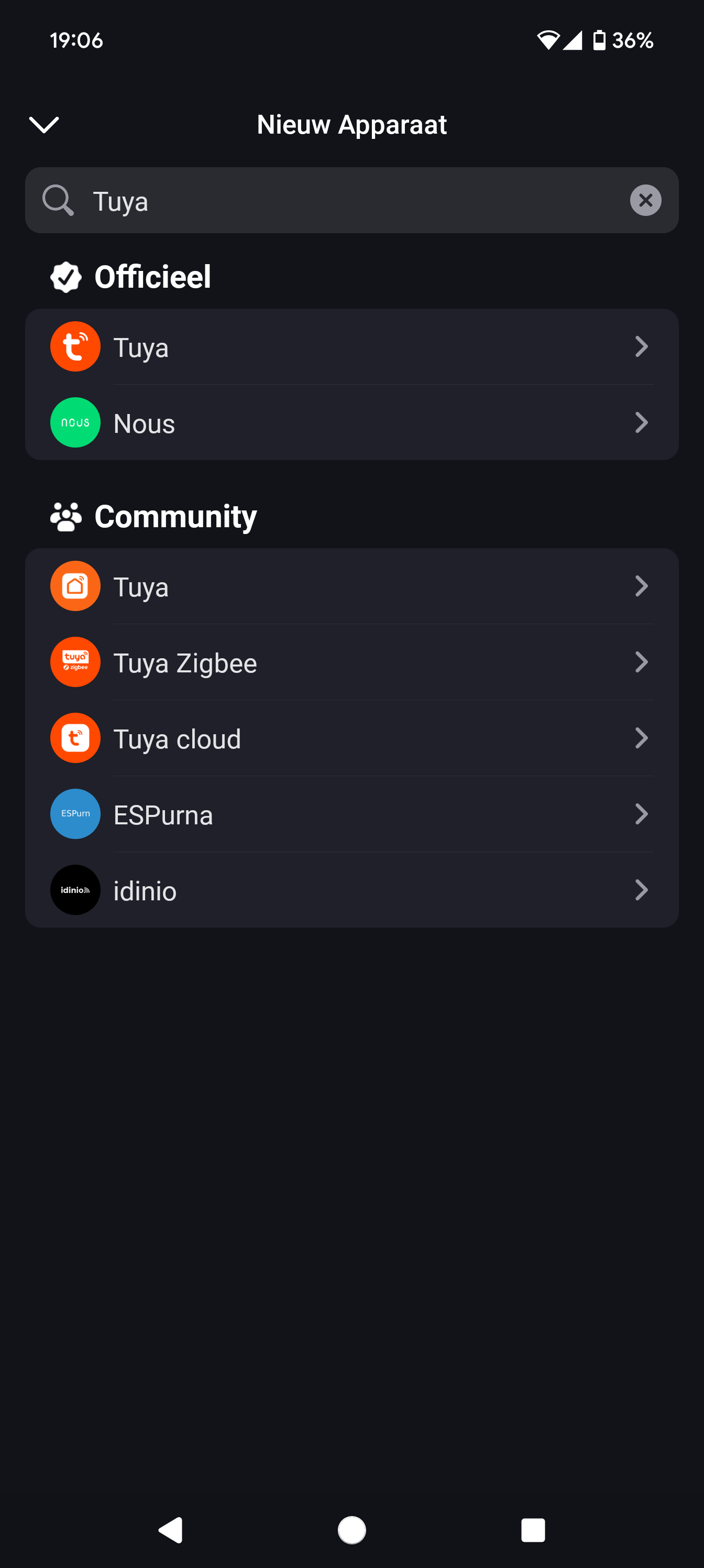

I choose the second community of the list ( see image).
Support for that device was added 3 years ago already (in v0.2.0), so I don’t know why Homey keeps saying it’s unsupported. Perhaps reboot your Homey to see if that fixes it, because it’s also strange that initially you were showing v0.1.45 when you say that the test version was already installed (there can’t be two installed versions of an app).

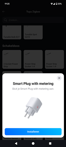

Very strange yes, I delete every Tuya application.
Install the new test version, look for Tuya and find my device it find it and not supporting.
After that my app is updated to the new version.
Is the name the same for Tuya experimental the same?
Need I look somewhere else to add this device?.
I try to reboot homey and try this methode again.
You specifically need the “Tuya Zigbee” app, not any of the others. Those are for Tuya WiFi devices, not for the type of device that you have.

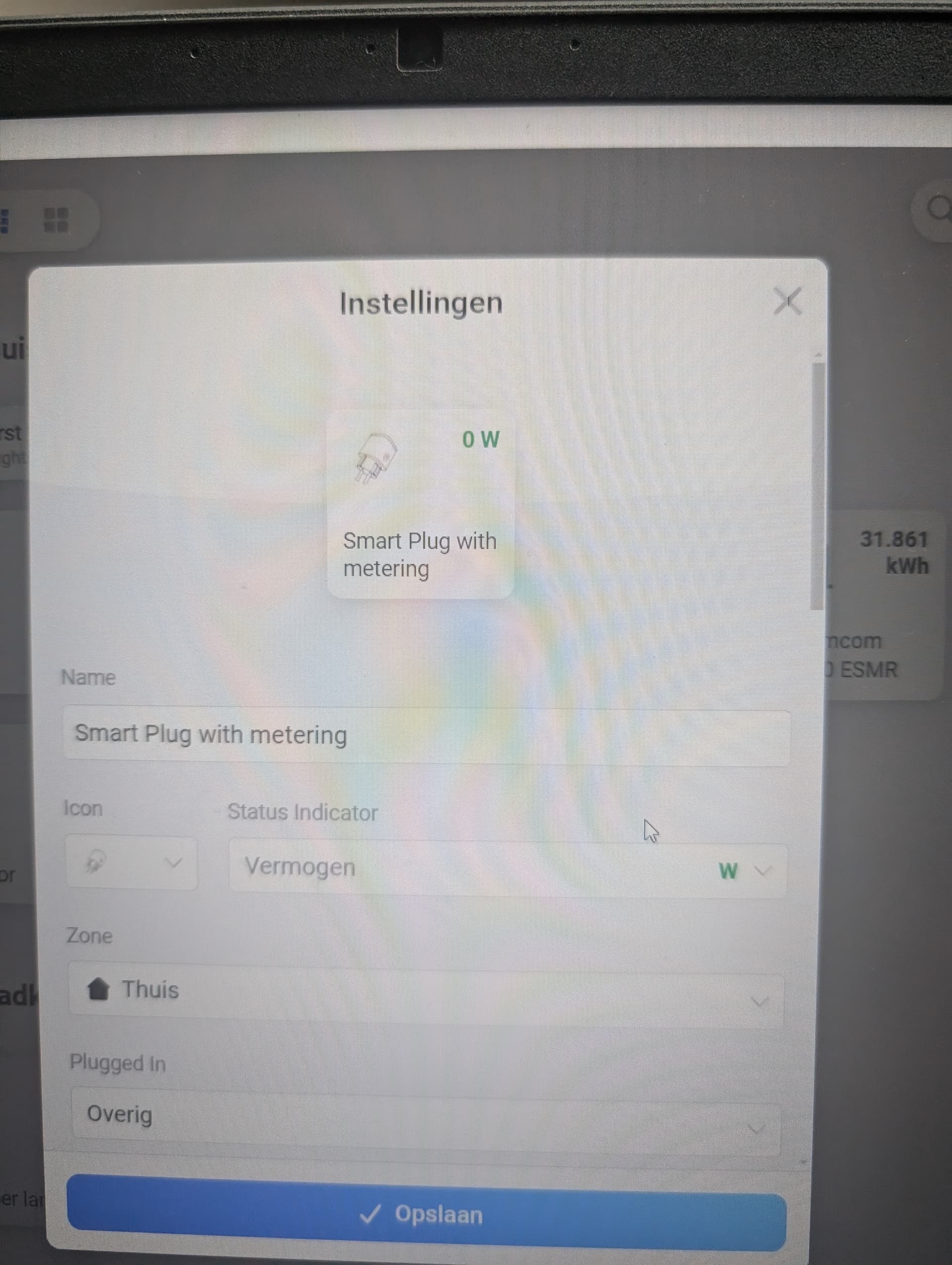

Got it to work!!!.
I use my laptop now with Homey web Application.
Delete every Tuya application, install V0.2.29 Test.
Add device , and directly added with metering!.
So the app on my phone did this weird shit.
