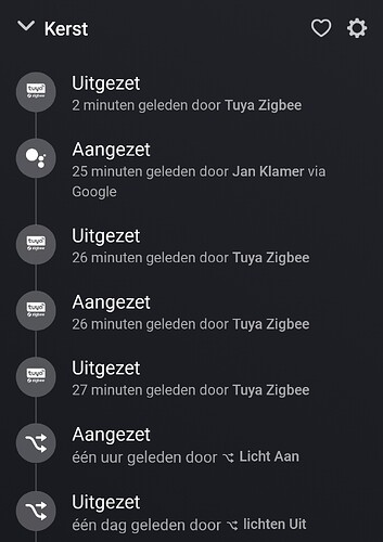

Weird behavior: the tuyazigbee app switches off a device at random :person_shrugging:t2:
I can switch it on again, seems to work normal and then out of nowhere it gets switched off.
Some IKEA devices respond to Aqara devices and vice versa, even if they’re not in the same Zigbee network. Perhaps that’s also the case here. Most Zigbee implementations have workarounds for this (unsubscribing the device from certain well-known broadcast groups during pairing), but Homey doesn’t.
