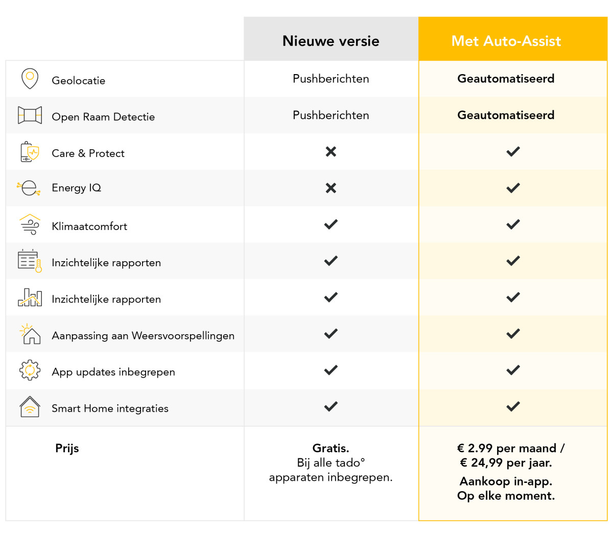

Is de EnergyIQ optie in TadoZones bruikbaar zonder auto assist ontgrendeld te hebben of moet je een abonnement hebben?
Als je een abbo nodig hebt voor auto-assist, lijkt mij dat EnergyIQ ook niet beschikbaar is via tadoZones.
Maar goed, installeer de tadoZones app en probeer het uit zou ik zeggen.

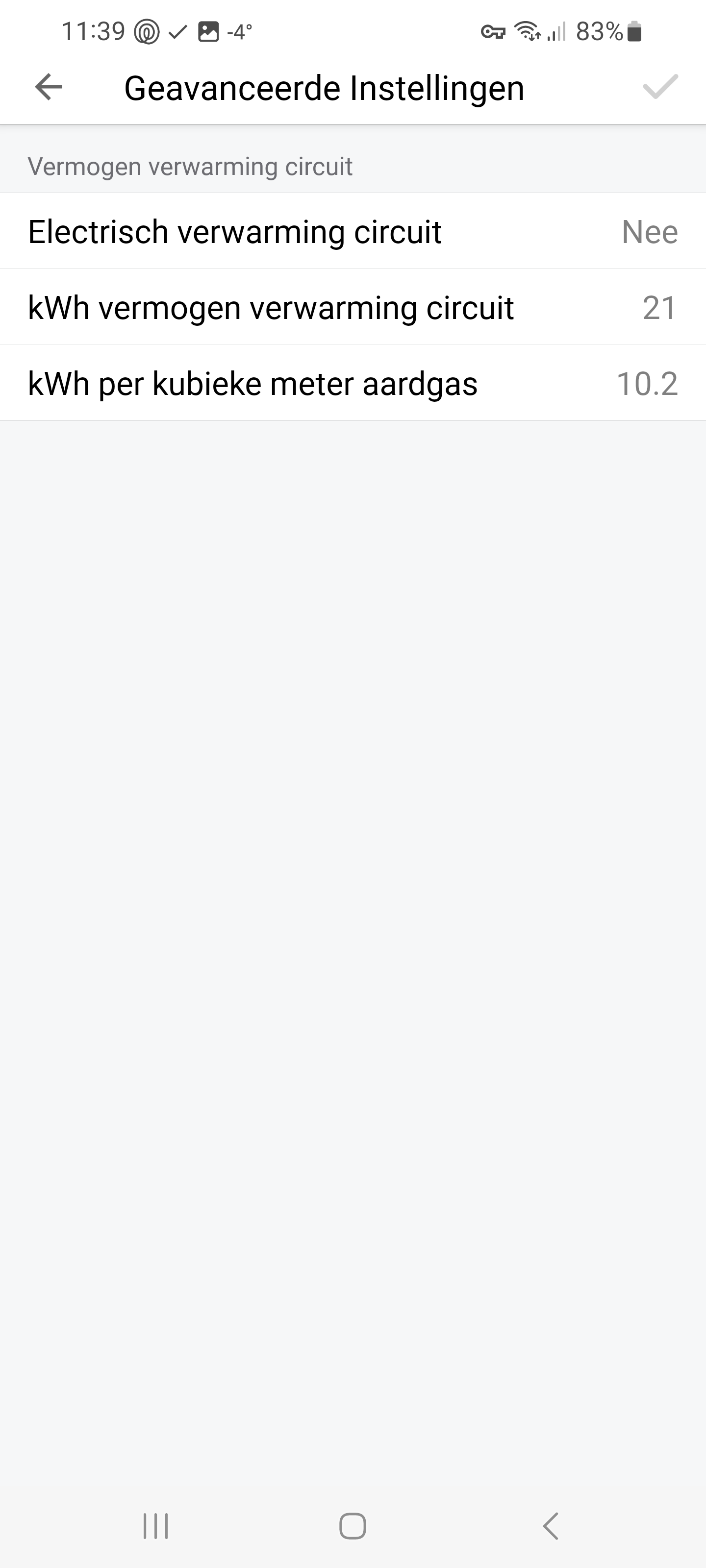

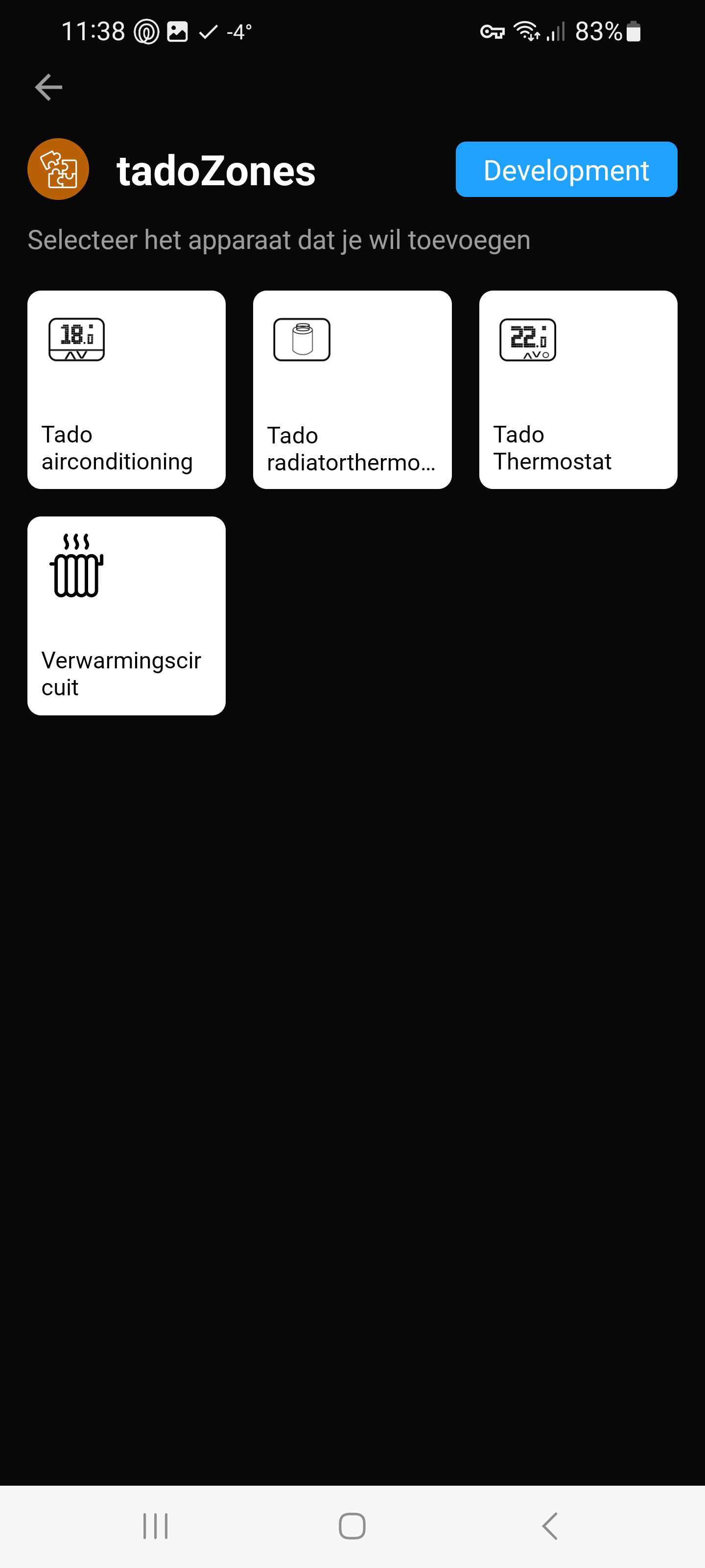

3.0.3 is released. It needs usage validation from you folks. Pretty big change.
In this version I introduce usage and a new device type (heating circuit). For all devices you should see usage of natural gas/electricity depending on your heating setup.
You should add the heating circuit(s), you can have multiple in a home, depending on the setup.
When added, you should then go to the advanced options of this device and input the following:
  • The power in kWh your heating circuit is running at (that can be lower as the maximum power of a circuit (CV)).
  • For a natural gas installation input the kWh you get out of a m3 of gas (in NL this is 10.2), but usually you can find this easy with Google.
  • If this is an electrically heated circuit, select that.
Your thermostats and valves will have additional info added to the device tiles:
If you have multiple on the same circuit it will summarize on the heating circuit as well.
You will also find when flow cards for both at individual zones and heating circuit for usage becoming gt and cost becoming gt.
Also new is an alarm for heating on/off to make it easier to react to a circuit or a zone providing heat yes or no.
For reset of counters there is an action fllow card, so you can choose the time or event for counter reset yourself.
The tariff for the installation is currently taken from EnergyIq, i will introduce a setting for non-energyIQ users in a next update.
If you find issues or problems please PM me. And if you have huge problems, just go back to V2 latest.

Thanks for this update, Martin!
How is the power (kWh) of my central gas heating unit influencing the calculations?
That is the basic number, together with the number of kWh per cubic meter of gas
If you check the documentation of your cv you will find the heating capacity in kWh. Only thing to watch out for is that the equipment might have been set up to run at a percentage of the max capacity.
E.g. in my case I have a cv capable of 30 kWh, but running at 21. You should be able to check that in the manual as well on what the power is set at.
