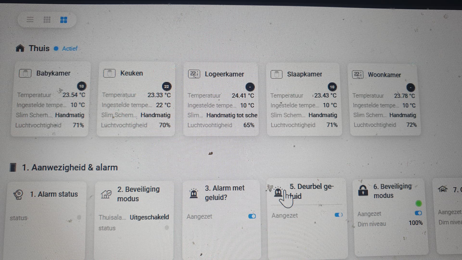

Ook kijken logeerkamer en woonkamer niet de ingestelde temperatuur door te geven aan de tegel, zie foto
Er komt binnenkort een update om dat probleem te verhelpen.

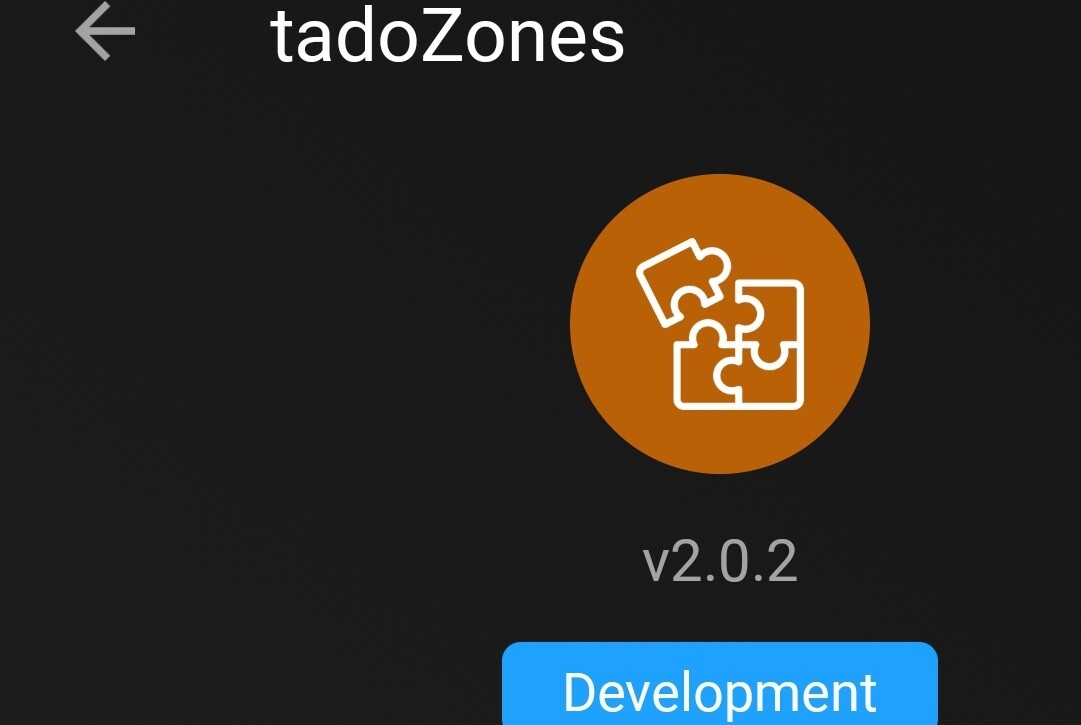

2.0.2 should fix that. Still a problem exists in AC setting target temp, will be fixed later.

You have 2.02 running?
because before that the description for setting hotwater temp and thermostat temp were the same, and i changed that.
Yes,
Note: I installed it, as usual, as an update (I never removed the app before). Maybe this is relevant.
If I need to test anything, just ask.
Thanks.
Not needed. Just checking the obvious
