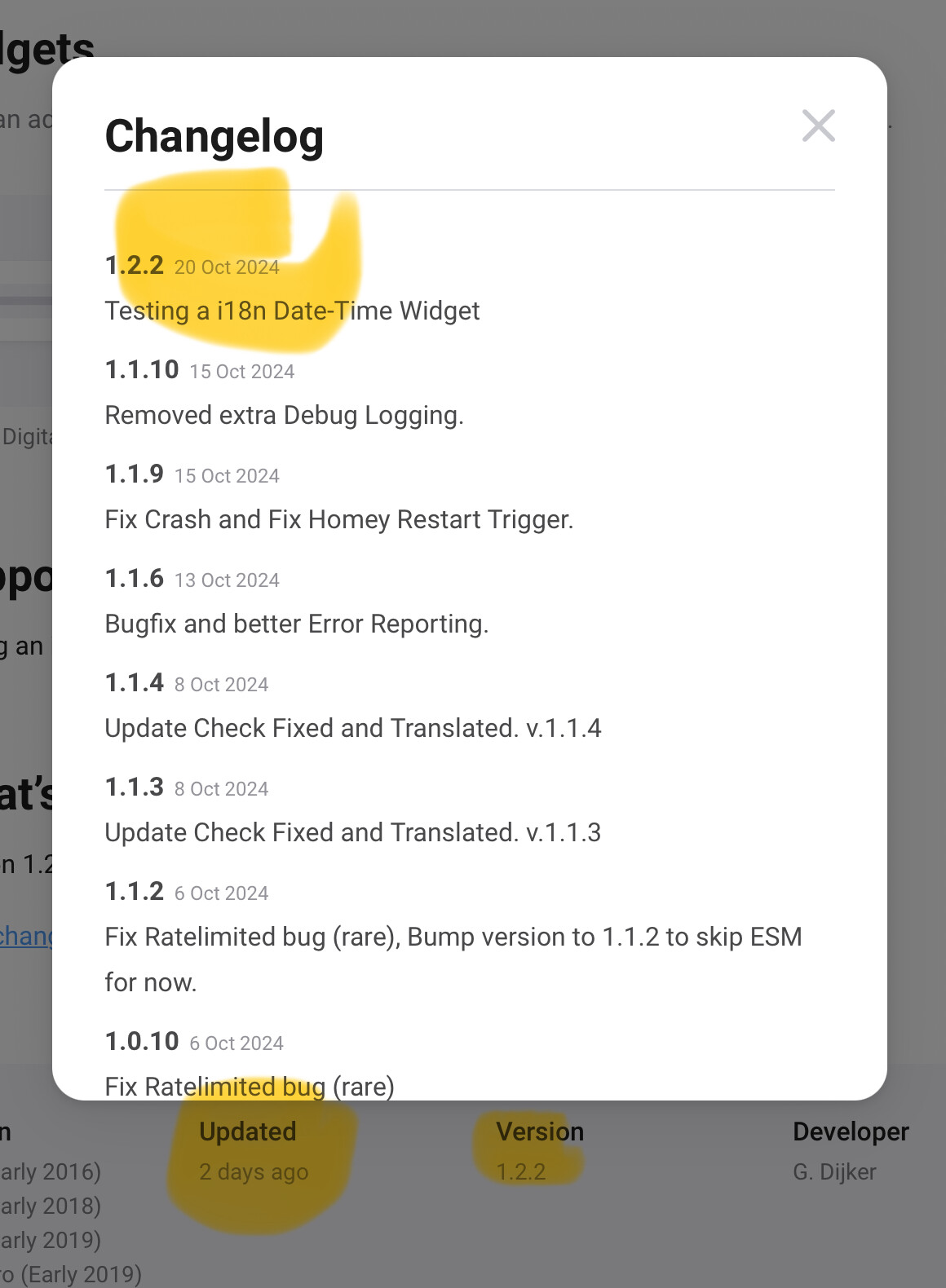

@Dijker
Inthink the changlog is out of sync?
20 Oct 2024 vs 2 days ago? Both referring to 1.2.2
Imho nothing to do with the app, just how the appstore works.
It is only promoted from test to live version 2 days ago.
Ah sontest started in 2024? I get it
