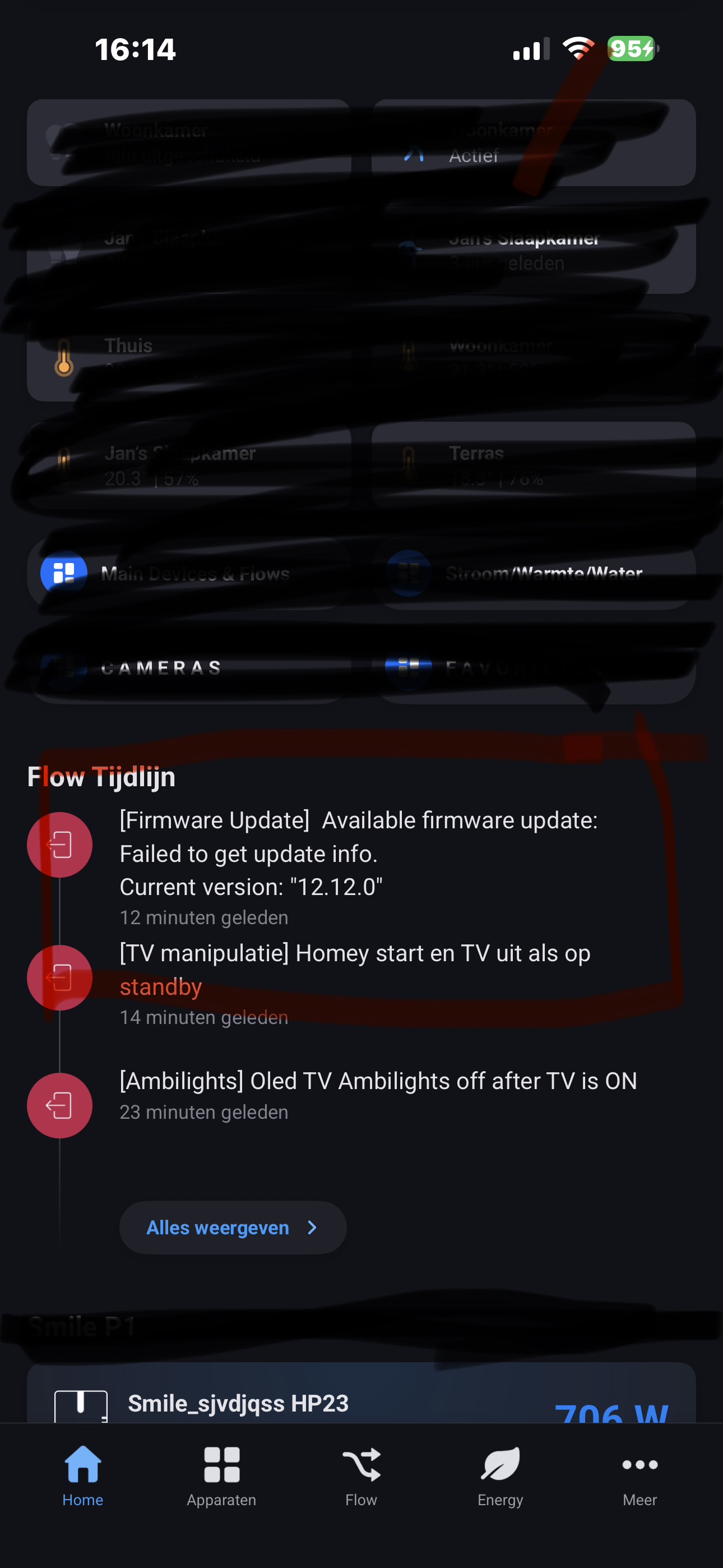

@Peter_Kawa For your information/heads-up. Somehow I just got a message/reminder that there is a Homey Pro 23 firmware update available just a couple of minutes after a restart of my Homey Pro 23 (after beeing shutdown through a Shelly smart power plug :electric_plug: for 17 minutes).
No update available:
Will investigate this if my own flows are faulty but just in case …
Hmmm , not quite. It said: Failed to get update info
That’s not like: here’s update version x!
