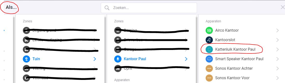

Yes sure,
When my smart lock locks my office (when the smart lock state is set to locked), the pet door installed in that office should keep all cats out (set state to exit only).
I will try to make some screenshots to make it more clear
Als = If
In this step I can see the individual pet door named Kattenluik Kantoor Paul
So i can trigger a flow using this individual pet flap

I hope this clarifies my intention a bit better
Thanks for taking the time to respond!
