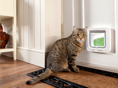

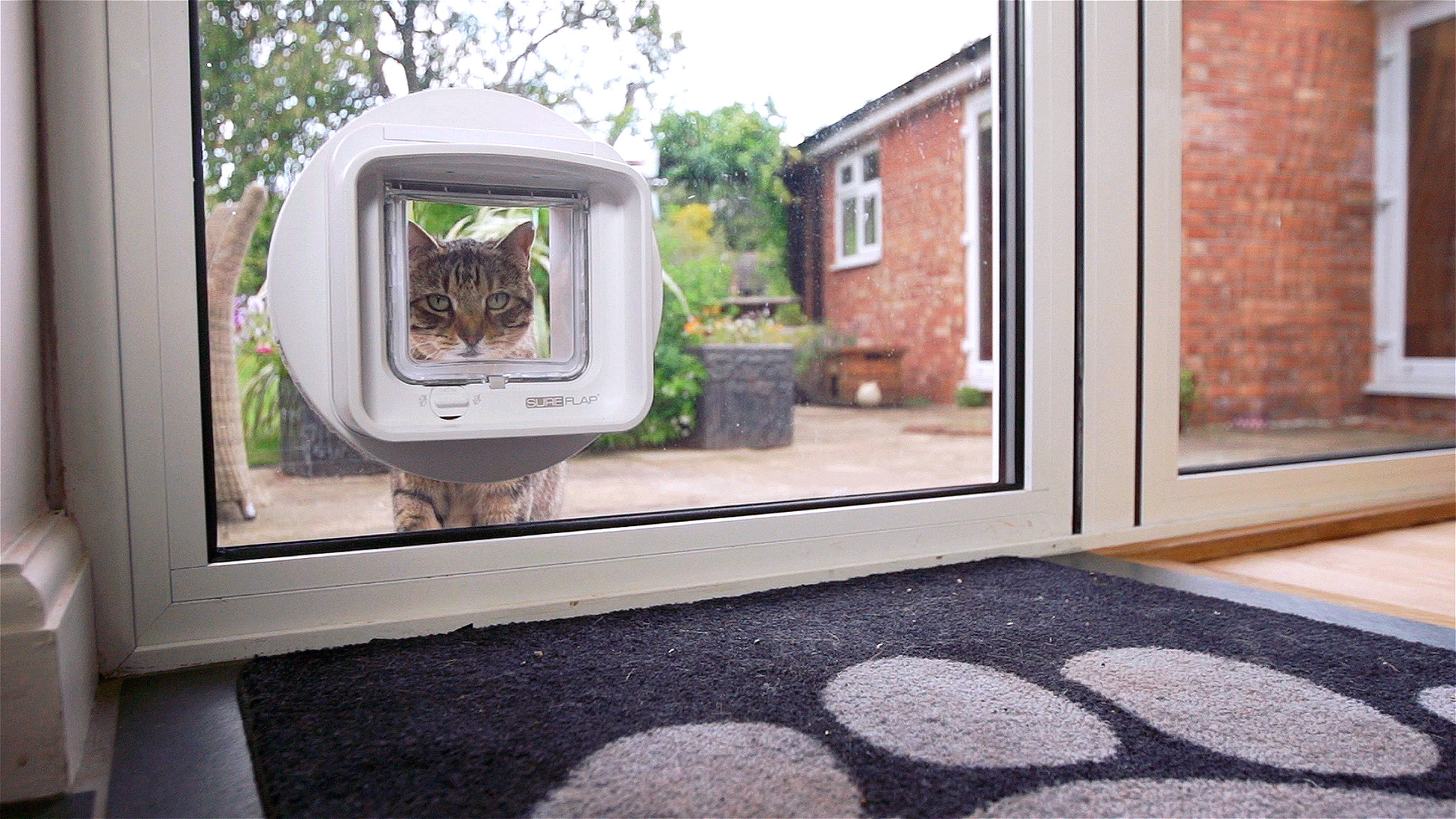

@MarcoRuiter is it possible to scan a cats id tag and right then and there decide whether to open the cat flap or not?
I’m asking, because we’d like our current cat to go outside whenever he wants but keep our kitten indoors for now. I suppose i can simply skip scanning the new kitten’s tag (for now), but in the future i’d like to be able to give them separate curfews.
@Bazeloth Yes, that is possible. You can assign access rights per chip (cat).
Yes, no the catflap only (not the petdoor) and not a curfew for both. Just mark them as indoor kat yes/no.
The “huisdierluik” (or “pet door”) only scans when pets go inside, not when they’re going outside, so you actually can’t do what you want with that one.
To keep certain pets inside, you would have to buy the “DualScan” cat flap:
But that one doesn’t have a connect variant.
Edit: seems like I was wrong on that last one. The normal cat door connect also has DualScan, (but the bigger “pet door” doesnt):
