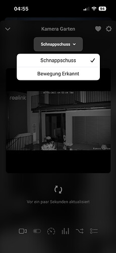

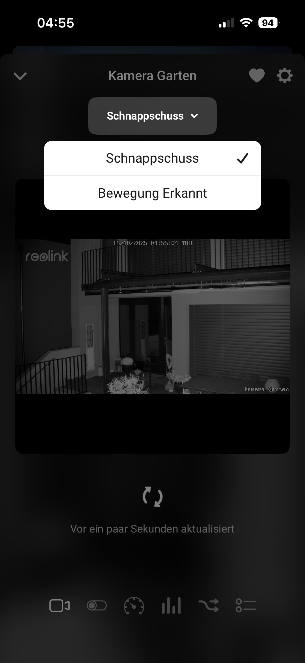

Since version v2.0.59 the live stream no longer works. I have HP23 (Vers. 12.8.0) and 2 Reolink cameras. The “live” function is no longer visible.
If you need more information or a log, please contact me.
Thank you very much for your help.
Homey is running on 12.8.0 stable (Homey 2023)
