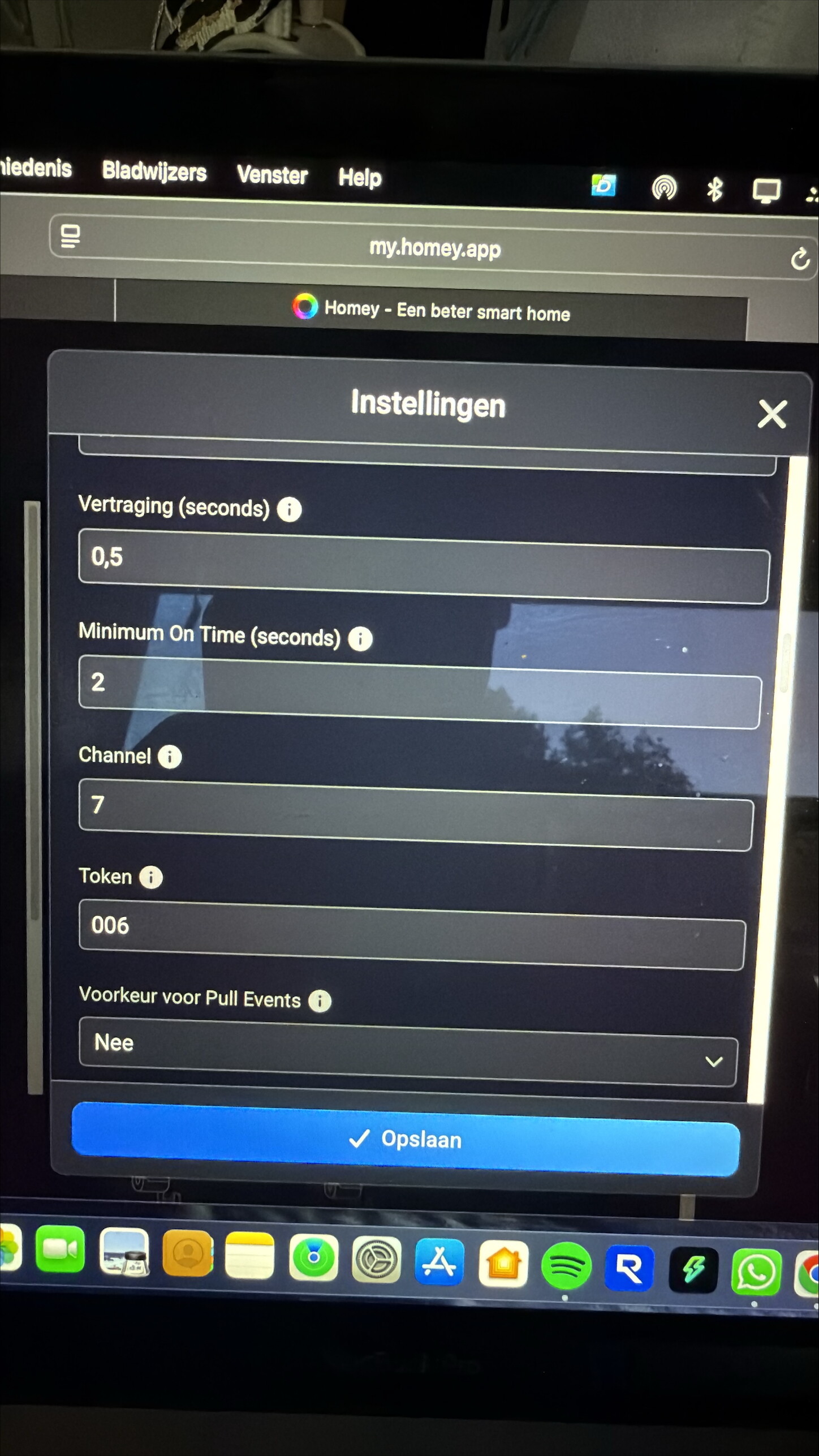

Hi Adrian,
I use the test version. But there is no PTZ option in the ‘camera’
(attachments)
If there is no option to select a pre-set in the device card, then it indicates the camera is not reporting that it supports PTZ.
Could you open the app settings page a select the Diagnostics Log tab. Then set the Log Level to Detailed Information and make sure the log is clear. Then restart the app an allow it a minute to start up. Now go back to the Log page and send the log.
