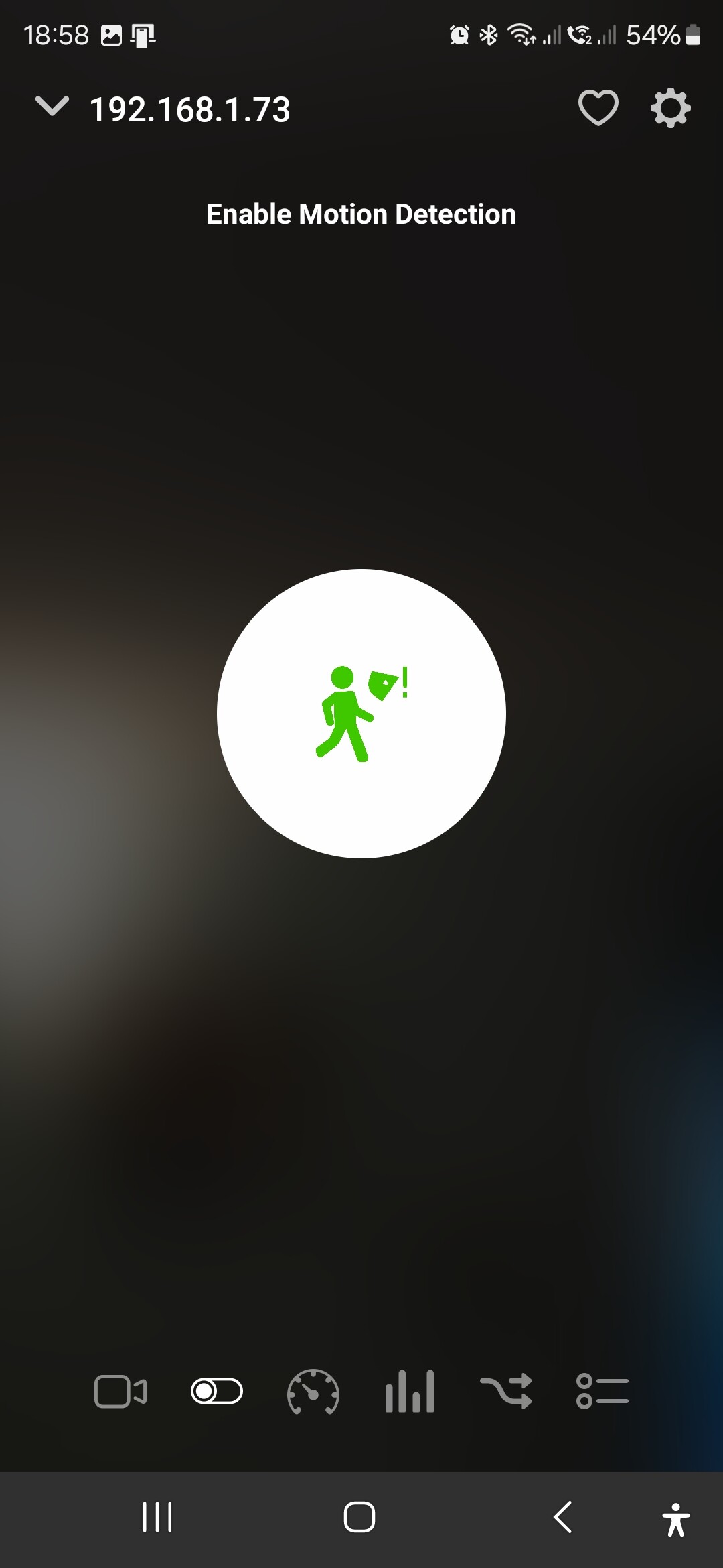

Have you turned on motion detection in the device?
That makes sense, I switched it on now and sent the log again.
In dutch this page says “Montion Detected” so I thought this went to green the moment motion was detected. Not sure where to change the translation in dutch but it would be beter to name it “Schakel bewegingsdetectie in”
I will change the Dutch text.
The English used to be “Motion Detection” which also confused users, so I changed that but forgot to update the other languages.

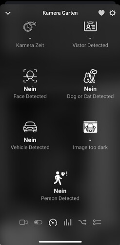

Here are two more cameras for your list that are supported by your app:
  • Reolink RLC-823A 16X
  • Reolink Track Mix Wifi
All functions of the camera are taken over in Homey, except the camera time, which surprises me. Because the movement triggering time including date is indicated.

The movement date uses Homey’s time but it’s strange that the camera time is not showing. Maybe you could open the app settings page and select the Diagnostic log tab, then set the log level to Detailed Information. Then restart the app and once it has finished starting up, go to the app setting page and send the log.
