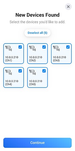

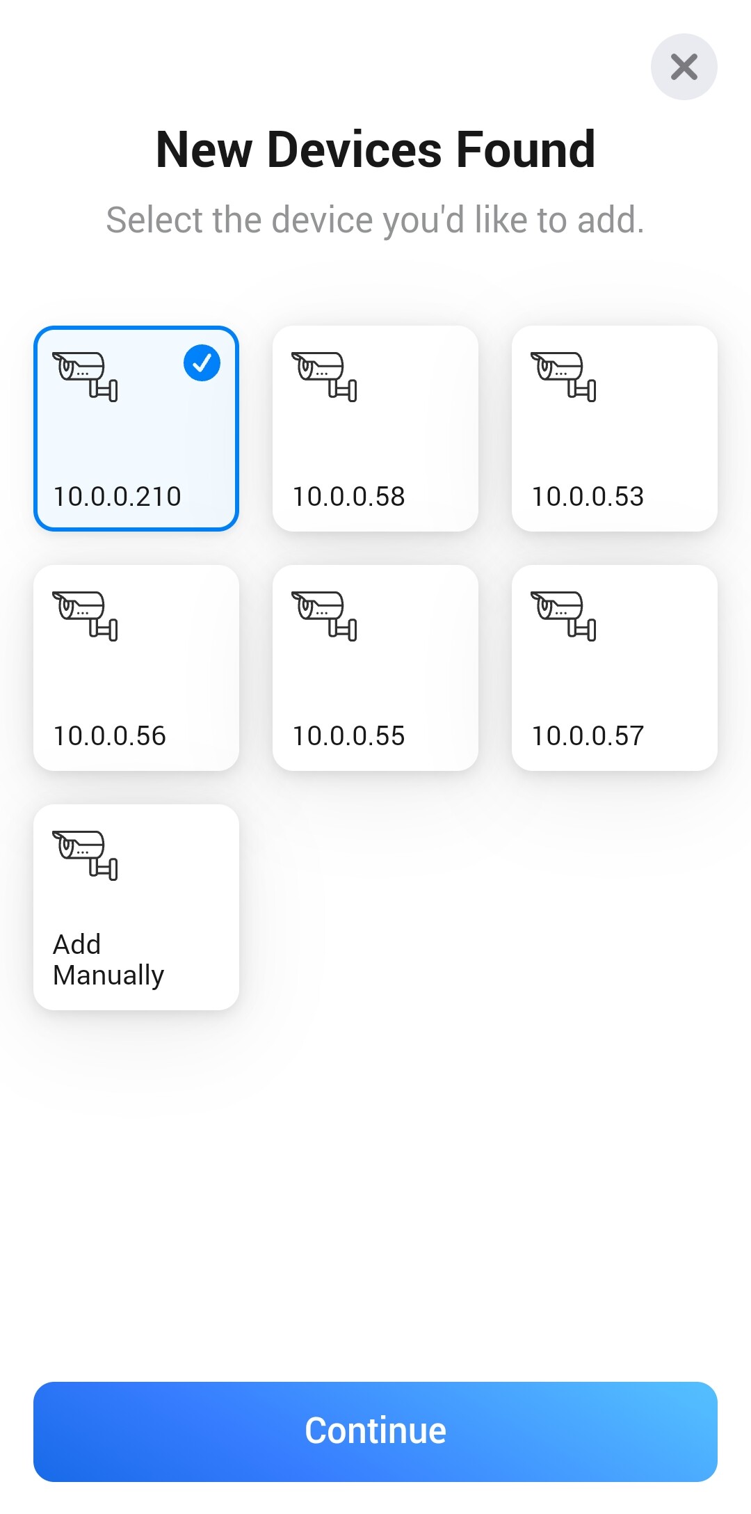

So I did it again. Removed everything, added it. In the onvif app it found the NVR (10.0.0.210) + also all 5 cameras, so I added the NVR only.
After entering the NVR login and password, it found 5 channels from the cameras.
I added to Homey and left everything unchanged, just activated motion detection.

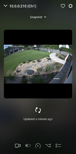

In homey, every added camera has the same Snapshot (only from channel one) and motion detection does not work (false negative).

Nice garden by the way @Mithrandir86
Thank you for the compliment. It’s not quite done yet.
