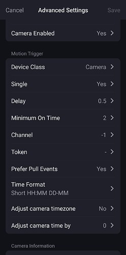

In the Advanced settings of that device. You can set interval etc.

I,'ve tried everything possible in Camera settings in Homey:
- Prefer pull event yes / no
- Change Type of notification to use to motion detect to:
- MOTION (IsMotion)…false positive
- ANALYTICSSERVICE (IsInside)…still negative
- MOTIONALARM (State)…false positive
- DIGITALINOUT (LogicalState)…still negative
- change Device class between Sensor and Camera… Also without result.

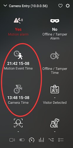

This are my settings:
Mabye it could be some problem with the time, because the camera time is not showing…

I made it and sent the log. I noticed that the camera time is showing now, but with wrong time. Mabye it could by some problem with it.
