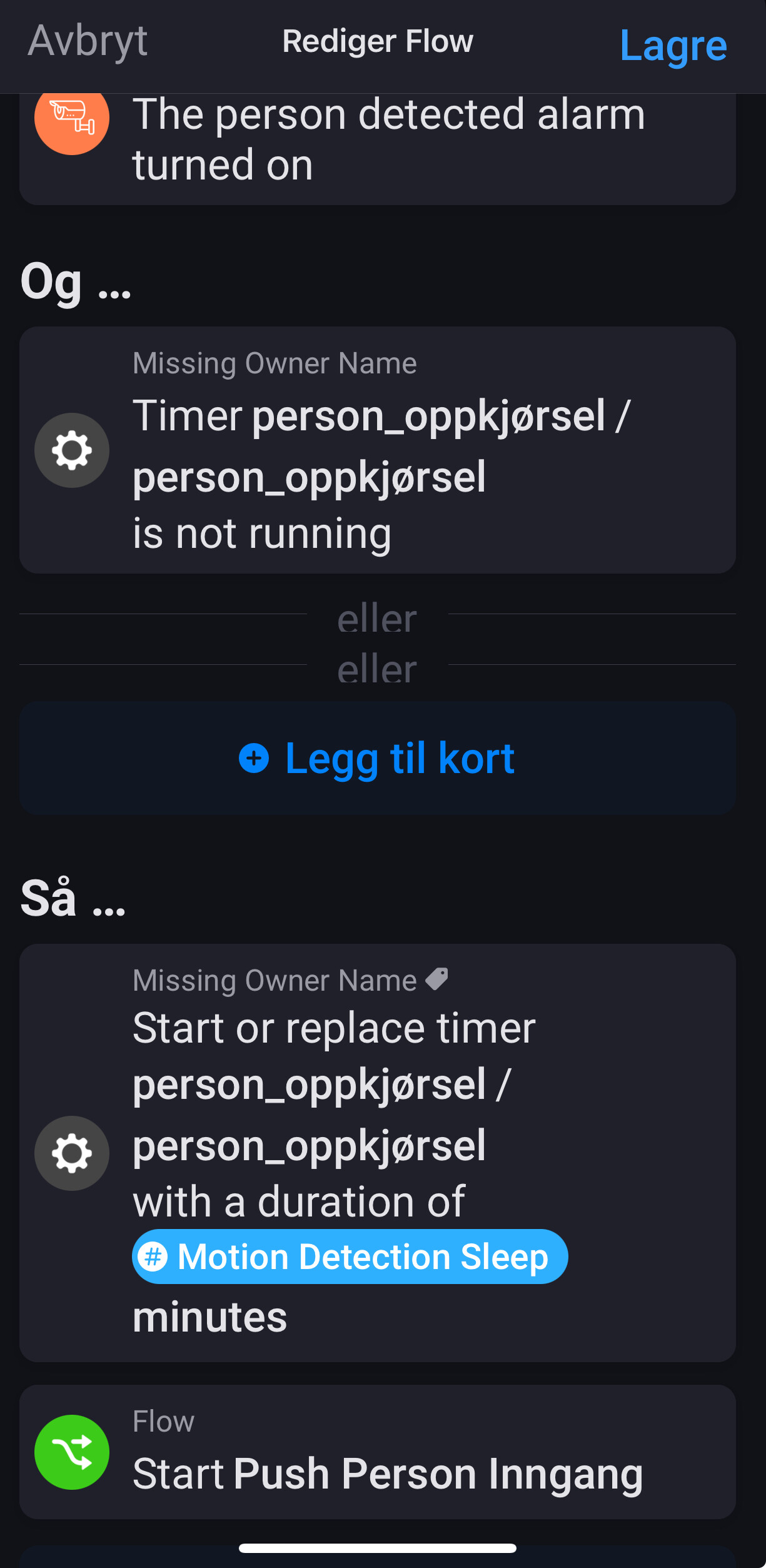

Hi, I have flows as following: one for trigger person(s) and one for triggering car(s) both cameras. (4 diff flows). All motion seems to trigger as expected, only problem is they trigger double norifications within same second. Only happends when triggered by camera motion, not when testing manually in homey. No other flows / triggers in homey have the same problem, only the two cameras. Have tried adding timers once triggered to prevent it to trigger again before at least 2 min have gone, but dont help. The reolink push notification only notifies once (normally not used as I want homey to be in charge)I will do some more debugging and isolations ……thank you for your time.
This is one of the flows
Basic information from double notification done just now. I dont see any obvious problem, but you guys knows best :slight_smile:
Any other suggestions to settings/changes to try?
