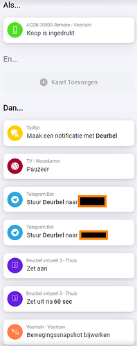

I have created the following flows:
This is working, although it always sends me an old picture through telegram. If I check the camera, I see the picture is updated as expected. But through telegram it sends me an old picture, sometimes from weeks ago…
edit:
interesting… I tested the build-in function of Homey to send a push message with a picture. There I get the latest picture, but through telegram I get an outdated one.
edit2:
I tried whatsapp and that is working well, although a few seconds slower.

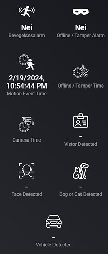

Why isn’t the camera time updating? :open_mouth:
Hmm, good question. It’s seems mine is the same but hadn’t noticed. I will investigate.
Ah, I see why mine wasn’t updating so maybe the same for you. Check to make sure the Diagnostic Log Level is set to Errors only. If it is set higher, then the polled routine that gets the time is disabled because it generates to many log messages.
I have two similar cameras. One I had to add manually. The info tab is showing more properties for one of them, why?

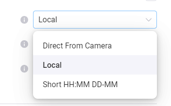

Is it possible to create a nordic time format?
Like todays date would be: dd.mm.yyyy and 24 hour time format mm:hh

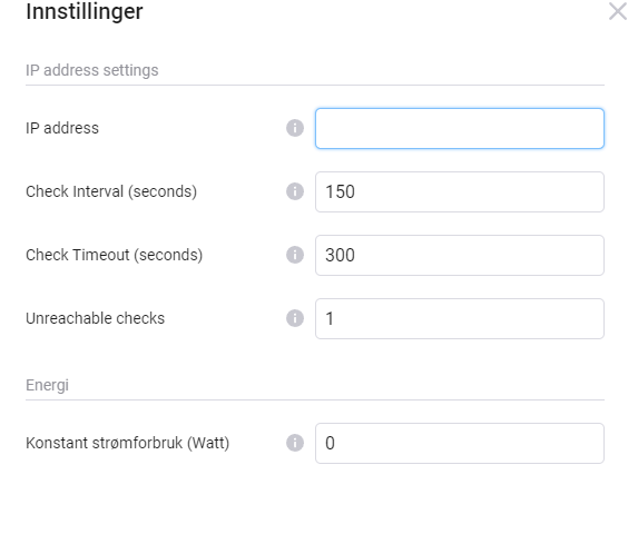

I have some devices that goes into alarm, but I can ping all of them from my PC.
I’m confused as I don’t recognise those settings. What version are you using?
Edit: Ah, I have just realised the last screen shot is from the NetScan app [APP][Pro] NetScan (Version 2.0.6, Test Version 2.0.8)
maybe a mod could move the above post and this one to the correct place.
In answer to the question, I would recommend increasing the Unreachable checks.

The capabilities displayed do depend to some degree on what is reported during the interview.
I will look at the date/time option.
