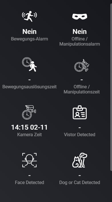

I tried everything to get REOLINK Cams to work. I can integrate them manually, but it’s crazy:
What works:
  • Snapshot
  • Timestamp (every 10 secs)
What not works:
  • everything else like motion alert.
What can I do, it’s crazy :man_facepalming:
Here is what capabilities on a reolink device is shown:
Can you confirm that you have the motion enabled on the button tab. A lot of users think that is just an indicator and don’t realise it’s a button.
ok @Adrian_Rockall this was to stupid to be true :wink: Sorry, I gonna send a few coffees to you… Maybe it’s possible to optimize the labeling of this button-page (I just see german). For such stupid guys like me :smile:
I think you are correct about changing the label as you are not the first one to be caught out.
What would you suggest is a good German label?
Thanx!
Now it is:
“Bewegung erkannt” = “Movement detected”
That means, that this button changes itself on motion. Even tho it is a button, not a sensor. But what should be told is more like “this button activates the motion alert in homey” I know its too long :wink:
Sometimes in Homey I find a “?” helpfull for give more info that this is not a condition but a decision needed for stupid users like me.
Suggestion from me:
“Alarm aktivieren?” = “Activate alarm?”
“Bewegung erkennen?” = “Detect movement?”
“Bewegungs-Alarm an oder aus?” = “Activate motionalarm on / off?”
“Bewegungsalarm aktivieren?” = “Activate motion alarm sensors?”
“Auto on” direct after integrating a device could be helpfull as well?
Thanks for the suggestions, I will ponder on them and pick one.
