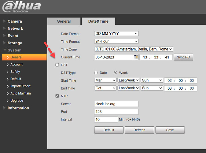

Hi, lately I’ve a problem with my Dahua Camera (model DH-IPC-HDW3841TP-ZAS with firmware 2.820.0000000.28.R, Build Date: 2023-03-14) and only with this 4K the camera get the block information from Homey. Till yesterday worked like a charm. The information I get with current camera is not available ONVIF SOAP Fault Sender not Authorized. Invalid username or password! You still have 29 attempt(s).: … and when I try to repair I get the message Error: Discovery error: undefined. If I cancel the camera I cannot add it again even if found on the search.
Somebody can help?
I also add this:
Dahua cam DH-IPC-HDW3841T-ZAS updated to firmware 2.820.0000000.28.R, Build Date: 2023-03-14 from firmware 2.800.0000000.11.R, Build Date: 2021-01-14. Working fine till update. After update various error. If canceled and try to add it again get the error Discovery error: undefined. Checked all the parameters in the dahua web page are all the same = no changes? Log file sent.
Have you tried to reboot the camera?
Tried to reboot the camera. Didn’t work. Tried the following: - reset to default (menu system default without users, etc.). Back to english and ok it did work. Changed basic parameter date and time and didn’t work again. Found out that if I ticked the DST didn’t work - unticked it works!!! Incredible. I also noticed that movement are not detected even if activated in Homey (previous version worked). Do you need some additional information for movement detection and/or solving the problem?
