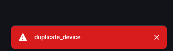

Hello there,
I wanted to add new cameras to my homey, however i cant add any new bcs of “duplicate_device”
I have 5 cameras added yet.
app version 2.0.42
I have tested few different brands of cameras all of them give me same error.
Every camera have static ip and i can connect to them with onvif thirparty apps.
Can anyone help me with that?

Hi Adrian,
Thank you for great app! I wonder if you can help with my problem. I have a setup where 3 Tapo C200 cameras are located in warehouse. Cameras are connected to a Wifi- extender. Managed to set up one of the cameras but for other two, discovery did not find them and when trying manually, it reports duplicate device.
When looking at the diagnostic log can see that it`s trying add the camera using Wifi extenders MAC. Also id and urn are same, extenders.
So it looks like the first camera was recorded with extender. Is there some way to fix this?
Best regards, Jan
Can you try the test version that I have just published.
