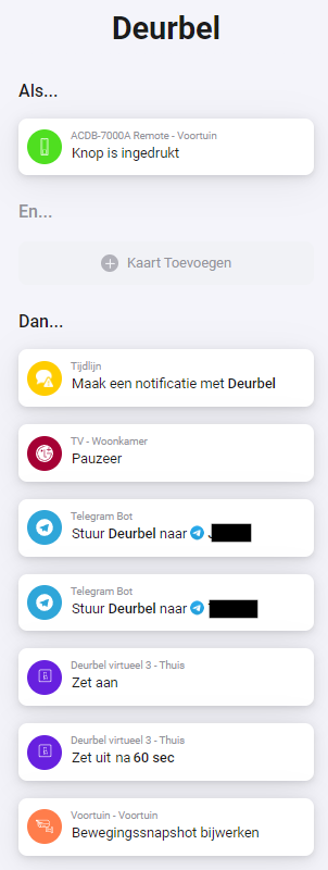

Hi Adrian,
I have the following flows for my Reolink camera:
However, I am not receiving a snapshot in neither Telegram nor Homey itself. If I click the camera and refresh the snapshot it works.
EDIT: while reading my post I saw the difference in ‘bewegingssnapshot’ and ‘snapshot’. Now I updated all to ‘bewegingssnapshot’ and it works!
