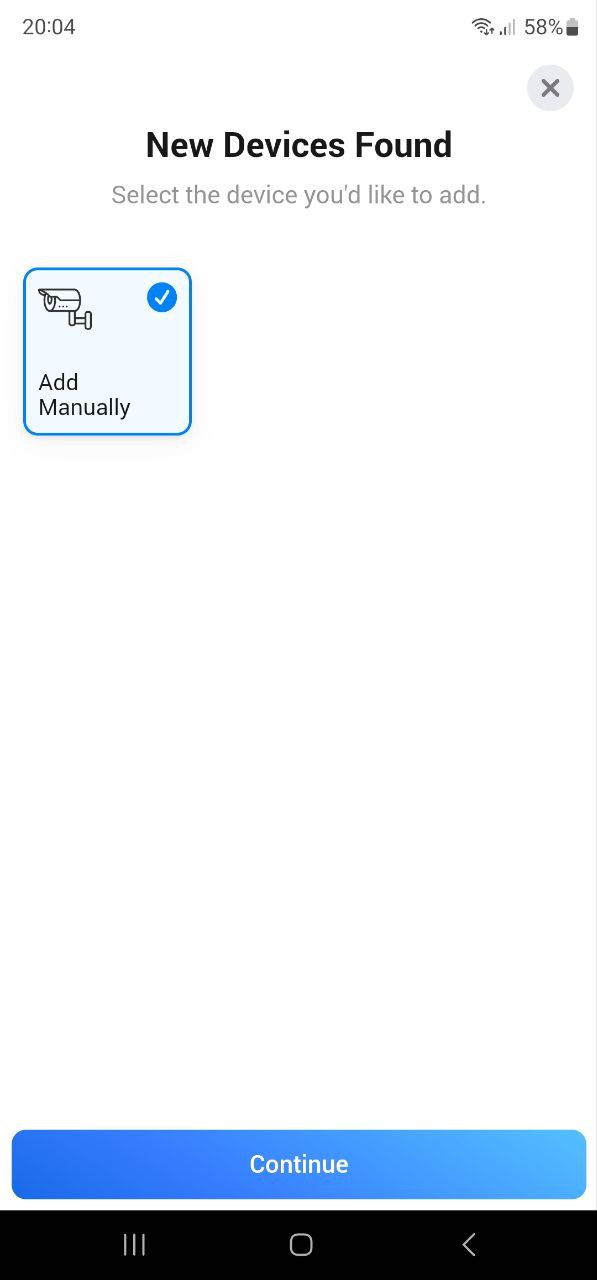

Iam having an issue getting my REOLINK RLC-842A cams working with the new Homey Pro 2023.
The old Homey worked without problems but now it’s not finding any cams and i have to input them manually.
When i fill in all details i get and message: ERROR: could Not Get MAC Address
I have latest Cam firmware V3.1.0.0 , ONVIF V2.0.30 and latest Homey 10.0.0-rc.105 installed. ONVIF is enabled in the settings and https connection. both account admin or user account in reolink will get me the same error.
What is going wrong, do i need to set something in my REOLINK cams.
Can you try the latest test version, 2.0.40.
Hello and thank you for your suggestion i have tested it but still same ERROR: could Not Get MAC Address
Does it find the camera automatically with the new version?
Hello Adrian,
It says it found new devices but need to add them mannualy. after i type in the network specifics i get again the ERROR: could Not Get MAC Address
The “Add Manually” option appears if it can’t discover any cameras. Also the MAC address error also suggests Homey can’t communicate with the camera at a basic network level.
