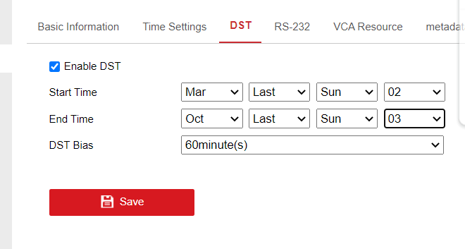

I have some Hikvision Cameras connected, but it seems the Onvif app doesnt sync the DST settings from the camera
on the left you see the onvif app, on the right you see the web interface of the camera

in the camera i can set the timezone
and another tab for the DST
the last sunday of october, the time wil be set backward, so i think i have to adjust this setting again, am i right?
or is it possible to add the same DST settings in the onvif app , so the time wil be adjusted automaticly ?

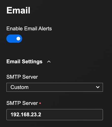

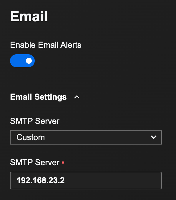

If you’re (quite) familiar with Docker you can try my SMTP2MQTT project which offers an alternative way of signalling motion events.
Thanks for your suggestions. Nice solution you made by reading sent mails (SMTP so I assume you check mails being send, not received). But to setup a separate system for just AI detection I find a little bit too complicated. There is also a Homey app “email” that checks for incoming mails but unfortunately that doesn’t work with my Ziggo mail account. I still should try with POP3 though. If there’s a REST option maybe Homey can still do the job.
It’s a mail server which accepts the e-mails sent by the camera, but instead of delivering them, it parses them to find out which event caused the e-mail to be sent.
(192.168.23.2 is running the SMTP2MQTT server)
