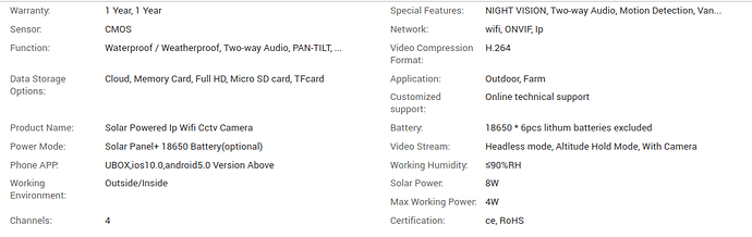

It’s written here:
Then it should work in theory, but no guarantees about it’s features via ONVIF.
