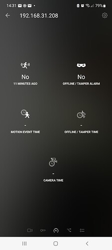

It looks to me that montion is permanently activated in your app (sending screen shot) and cannot detect any action (that’s why I was not able to seen anything in log file). Btw, the same result was for official ver. 2.0.12. from setup point of view, I went through this forum and configured device like it was commented here.
If motion was active, the alarm would be showing. The button in your post is how you turn detection on and off and that is in the off state.

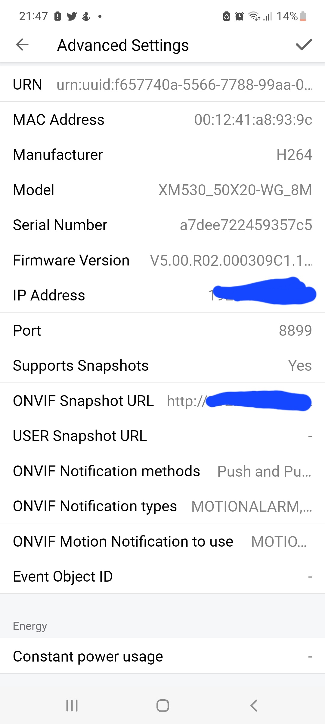

Sending configuration. Is anything wrong in it ?
Make sure the ONVIF Motion Notification to use is set to MOTIONALARM
Sorry for troubles but that change doesn’t work. Updated log was sent.
