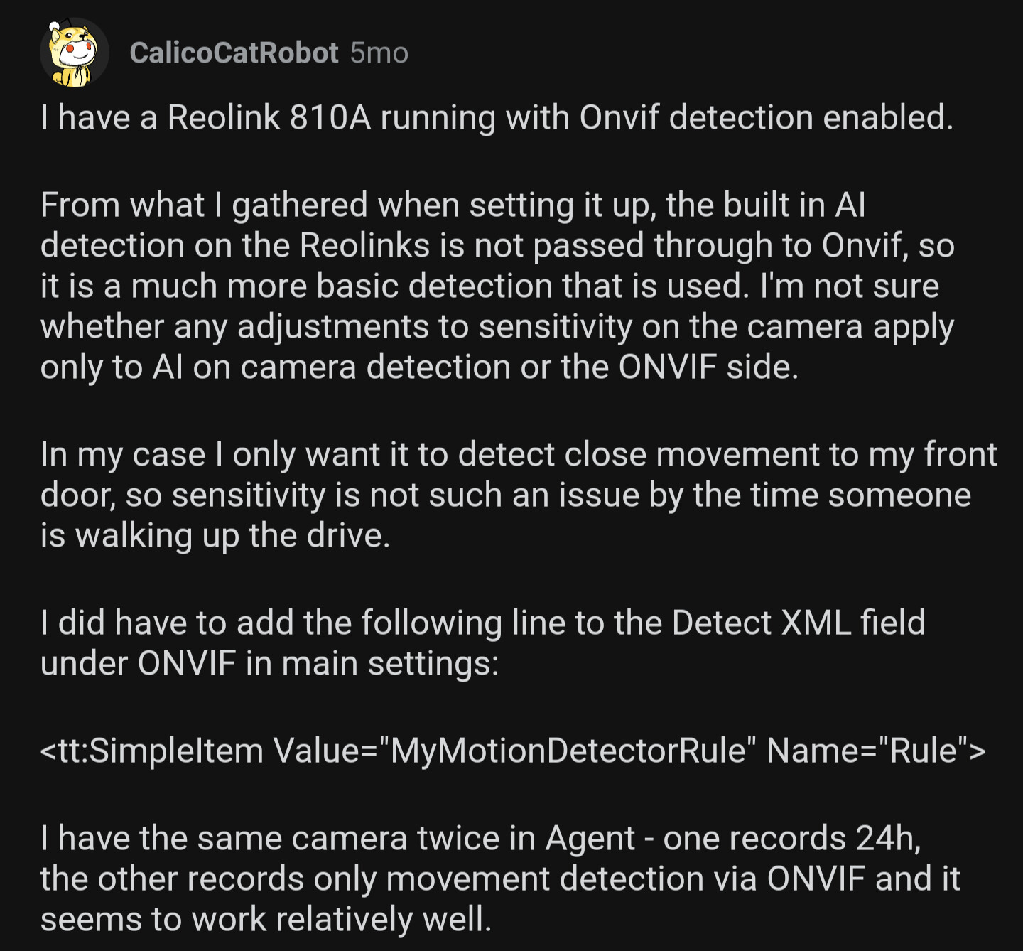

Would this below line make any difference?
If notification could be triggered using this line?
“Name”: “Rule”,
“Value”: “MyMotionDetectorRule”
Below redditor seem to be using that line for onvif detection.
No, as it is part of the same event message and appears every time for the “tns1:RuleEngine/CellMotionDetector/Motion”. If it only appeared in some of the events then maybe it could be used to filter them, but I’m not seeing that in the log.

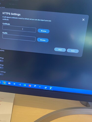

Hi, I do have the same issue and don’t know how to solve it…
Self-signed certificates can’t be verified so the https library rejects them. There’s a global setting to ignore those errors but that compromises the overall security. I guess as ONVIF is only local that might not be an issue.
Thank you for your very quick answer. Do you know where is this setting ? I’m having this screen but don’t know what to put in :

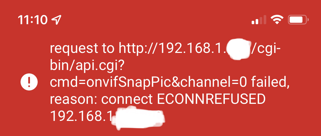

I did find it but now I have the Econ issue
And did solve the issue, I don’t know why but disabling https also disabled http. So make sure to activate http and disable https. Now it works. I will now try to add these cameras to homeykit. Hope it works.
