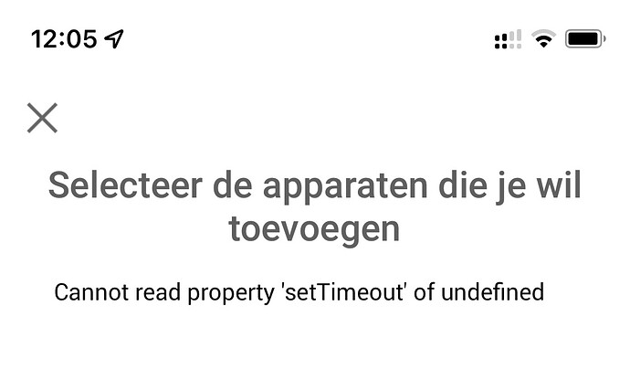

I am having an issue with the app. When I try to add a camera (that was added before), I get this message:
Is there a solution for this?

Thanks for reporting the issue. I can recreate it so I will post an update ASAP.
There is a new test version in the store.
Great!! It is working again.
Thank you for the fast response.

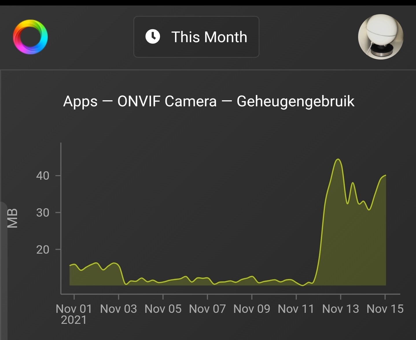

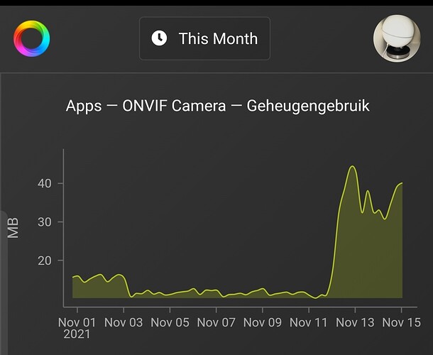

Hi Adrian,
FYI, the memory usage has more than doubled since nov. 12th on my Pro 512MB. It seems to occur after installing Onvif v2.0.1
Is this as expected? It is now the only app above 19.5MB
Cheers, Peter
I’ll have the same
