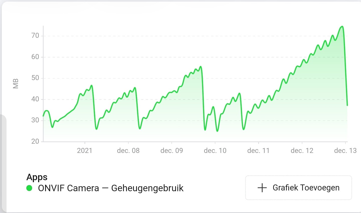

Strange. This is mine:
The memory can be quite high due to fetching the images and higher resolution images will possibly use more memory. However it should be a temporary increases while it is transferring.
I will go back through the code to make sure I haven’t made any mistakes in the SDK3 update.

RAM usage is still (too) high imho. I restarted the app every morning;
But not this morning, and now it’s rising to 55MB’s…
The cam’s barely send pics, just a few a day.
Any thoughts?
No hurries!
That’s strange. This is mine over the last 7 days, with 7 cameras, 3 of which are getting triggered quite regularly and the app has not been restarted in that time.
Also version 2.0.3 running on Homey v7.2.1-rc2.
Yeah, it’s quite odd. Before v2.0.1. the app used 15 to 18 MB’s, and nothing’s changed in my 2 cam setup or detection rates.
Could installing Homey v7.2.1-rc2 make a diff u think?
I’m installing it now anyways.
I’ll keep you posted, Adrian.

Hi Adrian,
Problem solved so it seems
I removed the cams and the app v2.0.3. Restarted Homey, installed app and cams, repaired flows.
Now RAM levels are perfect!
